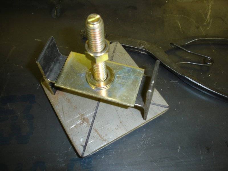

I made a 727 front clutch spring compressor tool from scraps I had laying around the shop. In the background is a Snap-On snap ring pliers. Expensive, but the phrase buy once, cry once definitely applies...
That’s what I did way back when. Same pliers, probably never use them myself again.

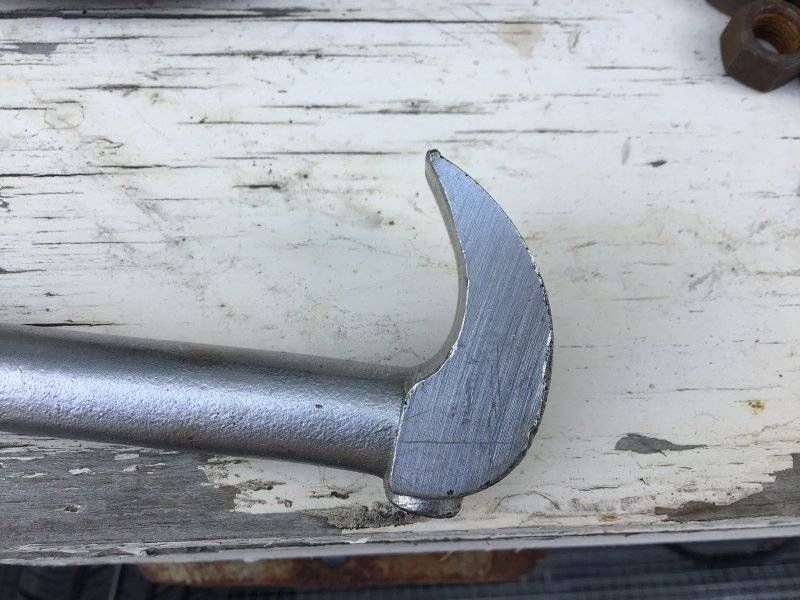

Good list here, but You don't need any slide hammers. First pic shows at the races on the pavement repair.
Thread a 3/8" bolt into the front pump holes @9 and 3 o'clock positions they are threaded, pry out pump body with a hook type prybar. A little bit each side and it's out in 5-6 prys. Last photo.

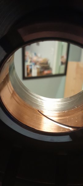

Ill be seeing them this weekend at the Nats for parts. I'm a bit curious to the wear in this area when compared to the image in the book at this point. You can easily see/ feel grooves but, what is too much!?
I usually dress this area of the steel drum with a hard white honing stone to smooth the area somewhat.
So are you saying this is usable with some prep?
It should be, unless it is a deep groove. Hard to see in the picture.
