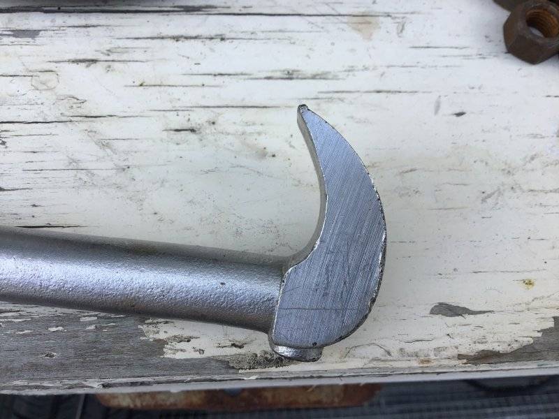

Good list here, but You don't need any slide hammers.
Thread a 3/8" bolt into the front pump holes @9 and 3 o'clock positions they are threaded, pry out pump body with a hook type prybar. A little bit each side and it's out in 5-6 prys.
