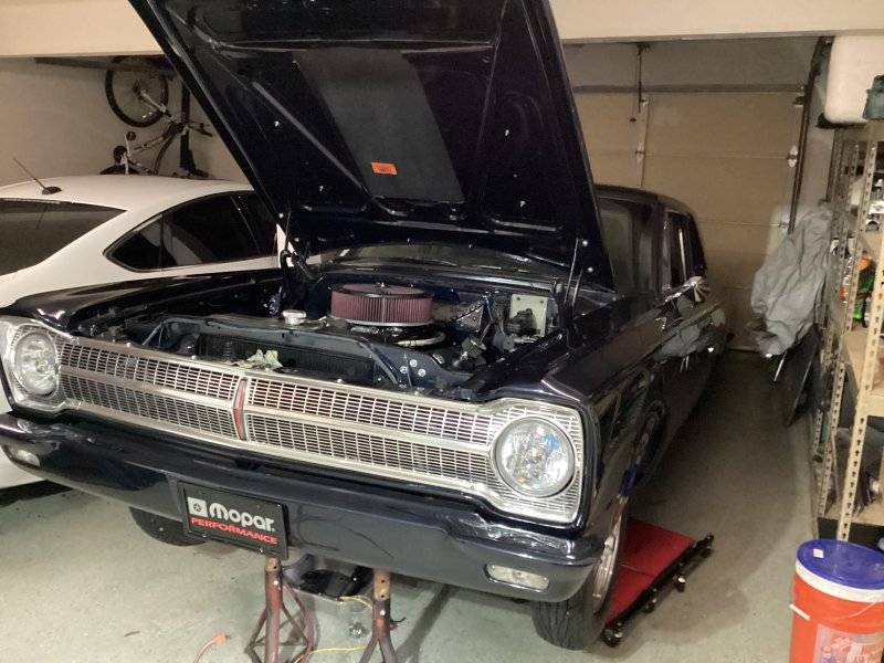

Been a while since I’ve posted here at FBBO, but I’m in need of some help….
a buddy of mine has a gorgeous 65 B-Post street/strip HotRod. Pretty standard 440/727 setup. last year he had a shop replace the converter. When he got it back, the shifter (cable B&M unit) wasn’t adjusted properly. He talked to them but just never got it back to them. Then reverse went out. He didn’t want to argue with the shop, so I told him to bring it to me it probably just needed to be properly adjusted.
I got under it and sure enough, the cable was tense and bound when in each gear. Routing of the cable was a mess….. so I spent some time sorting things out and got it to where I was sure it was adjusted “correctly”. Everything felt and looked right, but still no reverse.
I then dropped the pan and turned My attention to the low/rear servo and strut. Everything looked to be still in place correctly. So I then dropped the valve body and put some air to the rear accumulator. The servo worked perfectly and the strut activated the band just as it should. Adjustment seems slightly on the loose side, but it binds down the band just fine.
Im at a loss…. What to check next? Could the valve body not be operating correctly?
everything else seems to be fine other than “no reverse”. It is a stock valve Body with a kit as far as I know. Currently, when left in D, he DOES have low. So the overrunning clutch would seem to be ok (???).
anything else I should check before I throw it back together for one last “check” before pulling the whole thing to go through?
Help…….

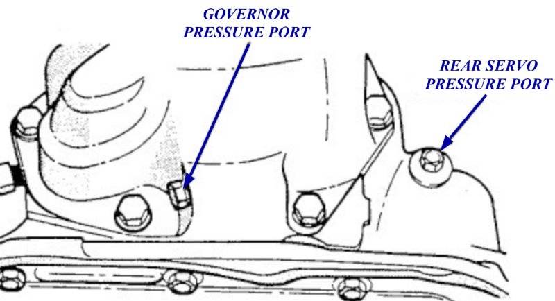

Remove the 1/8" pipe plug located on the side of the rear servo. Screw in a 300 psi gauge. Put it in reverse and see what your pressure is. Also test in manual low.

Been busy couple of weeks for me. Had to spend all last week and weekend moving my Mother in law into a home and taking care of all the details and legalities that go along with that. Then this week I’ve been in Dallas on a business trip. Haven’t had a moment to get into the garage. Im hopeful this weekend offers me some time.
Found the band adjustments were way loose somehow. Re-adjusted to spec (72”-lbs - 2 turns); and the lever extends about half of what it did prior. Front band also on the loose side, re-adjusted that while I was at it. I’ll button it back up today and see if that makes a difference, and run the line pressure test.
if still no reverse, out it comes.
Update: after the band adjustments, reverse works perfectly. In reverse, it must have been just free-wheeling the drum? Told the owner that loose bands to the point of not having reverse is likely a sign that the transmission is just plain worn out. Nothing broken, but probably needs new friction components sometime soon. Might not be the last time I’m in this transmission.
Backed it out of the garage and Test-drove the car around town before returning it to my buddy. All good. upon test drive, it seemed to me that the stock valve body, while working as it should, still felt very mushy between gears. I’m probably just used to my car which has a cheetah-body manual 727.
never did run the line pressure test, Doug. Probably should have, but it worked so I moved on. Thanks for the help, always good to learn.
