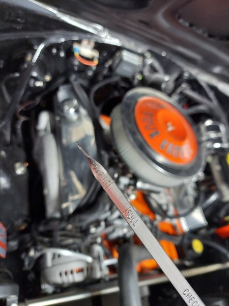

Ok....here it is....I am having a harsh shift into reverse from park or neutral. I have a 727 with 69 year stamps on it. It's been supposidly rebuilt before I got it. Fluid and filter looked new. I have dropped the pan multiple times and readjusted both bands to 72 in lbs and then 2 1/2 turns out. I put a new mopar deep pan, new mopar filter with extension on it, new mopar atf4+ fluid and I have a billet red accumulator with no spring and a rod that holds it to valve body, transgo tf1 shift kit(not manual) and i followed directions to a T .....twice to be sure. Fluid at full in idle. Correct idle? Always between 800-650rpm? I just feel like I'm seeing more band wear than expected collecting to magnets more than i like. Dark grey powder and fluid on magnets and a few very small flakes this last pan drop. Not putting very many miles on it all. Like 20 miles at most between pan drop inspections. Is the harsh reverse shift my issue, an issue at all or maybe not anything to be worried about??

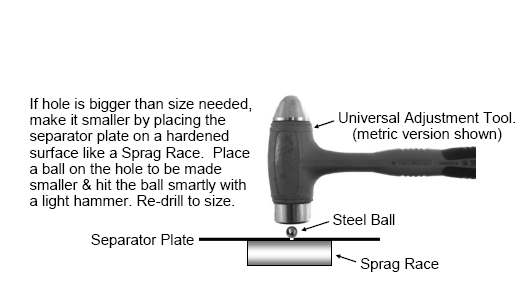

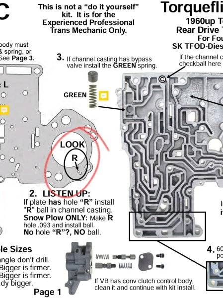

Ok. Thank you all for the comments. In case anyone is curious......here is what TRANSGO says about. They sent me this in an email. 2 pictures and a short story.
TransGo says....
"As for the harsh engagement it was just a very common and annoying issue on those, they were very prone to that. It's not going to hurt anything but if you want to make it softer you can do it.
I am assuming that the valve bodies you have don't have the "R" check ball we mentioned in the instructions. I have attached a screenshot here circling the hole in question. If you don't have a hole there you could make one yourself and go to about 0.060" and then add a 1/4" check ball in the pocket.
If yours already has a check ball and a small hole there you will have to make it smaller. To reduce the size of the hole you can use the method shown in the other image I am attaching here."
Robert

Those that say it will not hurt anything are wrong, with high line pressures in reverse it will break the ear off the band, fold over the little link, blow the lip seal and break the band linkage. I like the fix transgo sent you. We used to make that hole 1/8" and drill a 1/16" hole in the rear servo. Snow plow trucks would come in with broken rear bands all the time. I set the front clutch to .075 and the bands to two turns, with a new b@m traveler converter those transmissions lasted for decades, as the front clutch wore you would have to pull that restriction out of the front clutch with 2 turns on the band, rather than tighten the band we pulled the restriction. I started leaving it out and putting more spring under the front servo. I want a tight converter with 2 turns on the front band and at least .075 on the front clutch to reduce heat build up, but with a tight converter reverse was a big issue.
Reverse requires the high/reverse clutch and the rear band to both be applied. At rest with no rotation of the input shaft you will never feel the clutch engage. So no adjustments to the clutch circuit will have any effect on harseness when engaging reverse. The restrictor is on the orifice feed to reduce fluid flow when engaging the clutch. Fold the band link? Bend the linkage? Not in this lifetime. Breaking the ear off the band? Only ever seen that when reverse was applied while the vehicle was rolling. Very rare. Think about this. Line pressure gets ramped up with race valve bodies all the time. Very few modify the valve body to reduce rear servo pressure. Nobody reduces front clutch pressure. Do they break rear bands and the associated hardware? No. The trick Trans Go told you is to slow fluid flow to the rear band.
