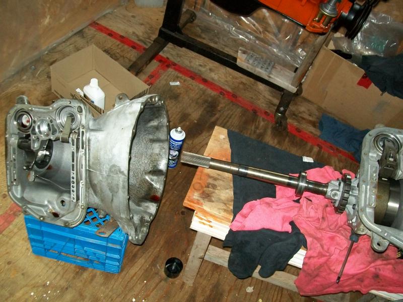

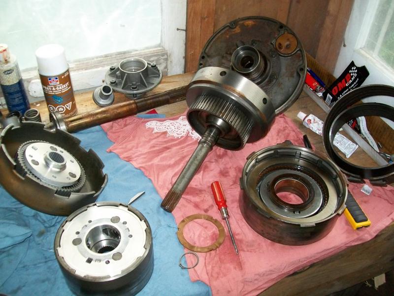

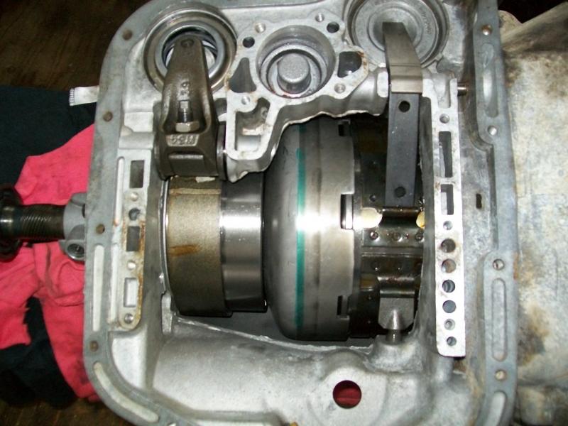

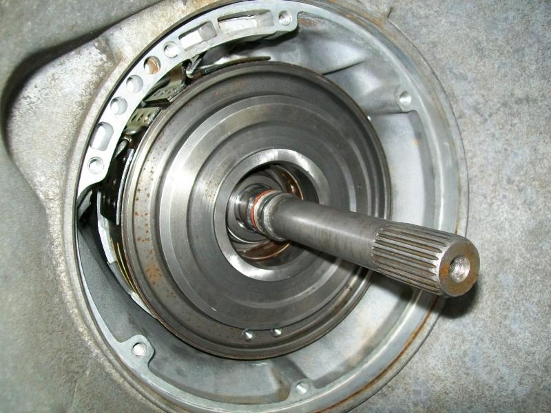

I had a good afternoon of moparing today. The smallblock guts are now in the big block case. Thanks for the tips guys. I just need a pump o ring and gaskets for the tail stock and exterior and I should be in buisness. I will throw some pictures up later on. Transmissions are pretty interesting to work on!
727 pics

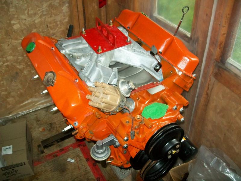

Here are some pics of what i'm working with, and what is going to be turning the tranny. My fresh 440
