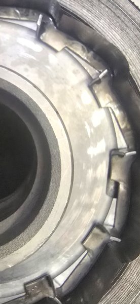

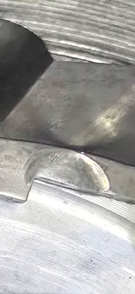

I have the sprag disassembled. I noticed marks that look like the rollers are digging into the holder. There's also some offset wear on the case. Is this wear normal? Trans has about 50k miles.

I have seen this. It doesn't seem to bother anything, but I don't like the idea of it on my own car.
What do you mean offset wear on the case?
What are you using the car for? Any drag racing? Any burnouts? Or just driving on street.
Its mostly a street car with the occasional burnout and some spirited driving. If it sees the drag strip it will only be a time or 2.

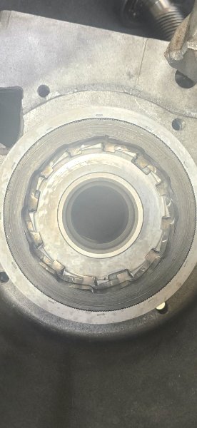

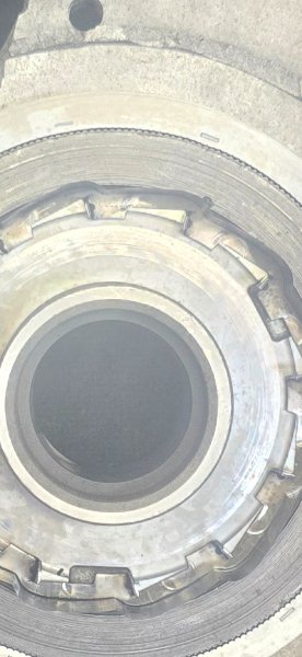

Ive attached better pics of the wear.
Thats not normal. I would replace it. The rollers, spring plate, and springs. I do a ton of these. Never seen that before.

Cheap to replace while it's apart. Rear drum seats in the sprag. Any damage to it?
Ill check the rear drum this evening.
