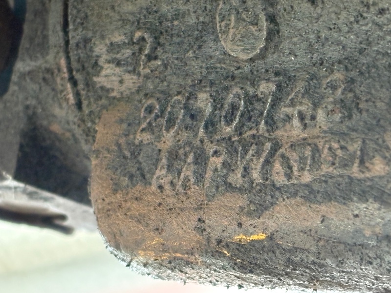

Is this normal?
What is the number cast into the drivers side lower area of the pumpkin? Where this says 742...
Can you see that ok? Looks like the same as what you shown.
That means the bearing preload is adjusted with shims so, a seal R&R is easy. Pull the yoke off (probably need a 2 jaw puller) and work around the seal with a small chisel until it pops out, install the new seal, install the yoke and torque to 250#s.
