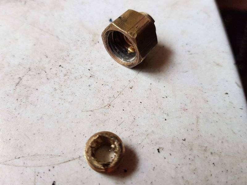

Just in the final stages of refitting my engine. Coupling up the coolant lines to the rad and the trans I have had to reuse some brass reducing adapters to fit the ally lines I have. The adapters were in both the trans and the radiator (I have fitted a new trans and rad). My car is a bit of a mongrel. In the process one of the adapters sheared on me, would anyone be able to tell me what I am looking for in order to replace it? Its this and an upper coolant hose thats preventing the car from being run!!
1/8" MIP x 3/8" inverted flare, I do believe. Ive seen some use 5/16" inverted flare as well. HTH, Lefty71
