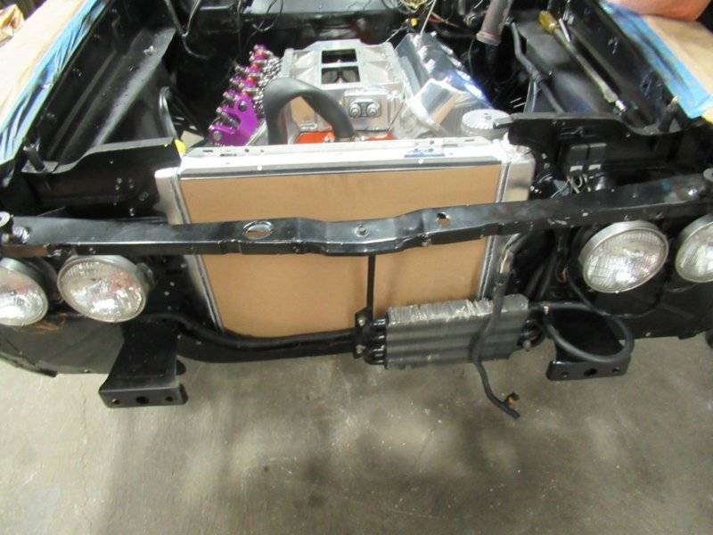

Do you know the stall speed of your torque converter? I would keep the aftermarket trans cooler hooked up, especially if you plan on towing. I feel for our European brothers and sisters trying to get repair parts and having to pay VAT and shipping.
Do you have a tube and fin cooler now or a plate style cooler? You might want to look at B&M plate cooler 70268 or a Derale plate cooler.
I run mine after it goes into the radiator on the output of rad I get a piece of 5/16 steel line and bend it so it goes right under the core support and bend it up to meet the cooler. I then flare it to put a barbed fitting on and just a short piece of oil resistant hose. The hose should take up some of the vibrations so you dont crack fittings on cooler.
Its what I do and it works for me, I get a 30 degree drop in temp from input to ouput of cooler before it goes back into trans. I check with infared temp gun.

The cooler is a 14"x10" tube and fin cooler, mine is lined up same as yours radiator first and after to the cooler.

Don't know about EURO availability but here is a picture of the cooler I usually use

I would just use the external cooler and no fluid in the radiator.That is all I do,on pump gas I am driving with over 700 hp.
Tube and Fin watch your temps do you have a IR probe? thanks for the pics Hemi
