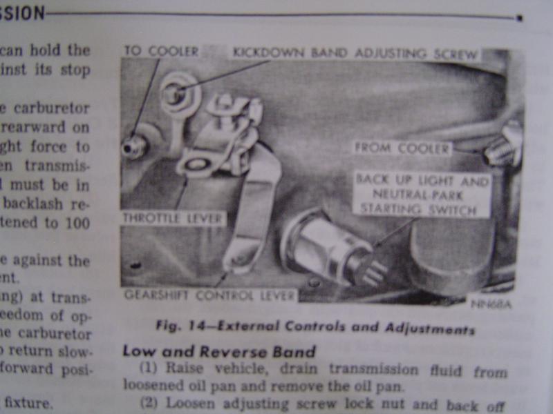

I have a question i should know the answer to but i dont. I have a 1969 Plymouth road runner that I am restoring. I recently installed the transmission (a 727 3 speed automatic) that is original to the car. My question is this: what is the direction of flow for trans fluid as it travels to the radiator and back: which fluid port (front or rear) takes the fluid to the radiator, and which port recieves it back from the radiator?

Front port is to cooler, rear port is from cooler, here is a diagram.
This is from my 73 service manual, but I believe is the same. Someone chime in if its not.
idrivemopar, awesome! thank you so much. diagram is great. one step closer to getting my road runner back on road. I really appreciate the fact that you took the time to answer my question. Thank you!
