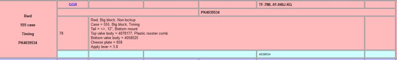

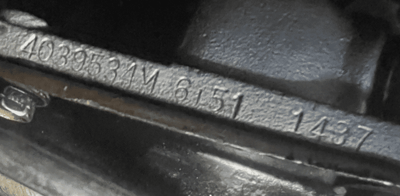

3515844. I get 1971 C body with 360 Unless it’s a truck tranny. Post some pics of the tail housing. My book only does car trannies.

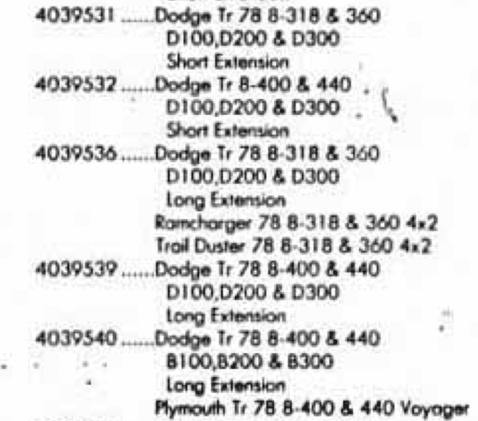

Here's a pic of the tailshaft. Longer than a truck - At least I think so anyway. I am curious to know what it came from though. But what ever it is- It's going in that duster now. I already got the kit and started the teardown. Thanks for your help bro - I appreciate it very much.
Yes it’s a car tranny. Tail shaft and housing are the exact same length car or truck long tranny’s. The retainer for the C clip is on the bottom. It’s the plate with the 2 Phillips head screws. Trucks have it on the drivers side. Kim
