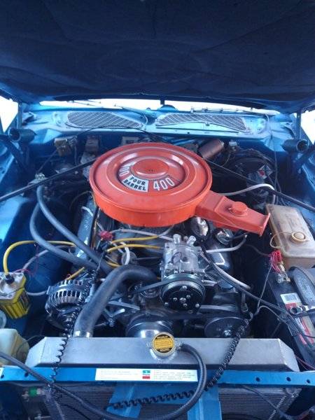

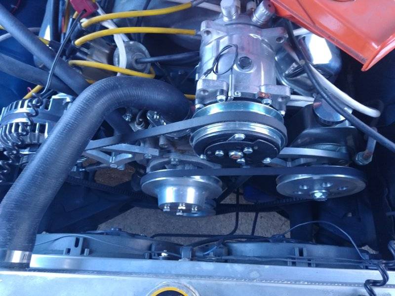

Yeah 440's are awesome! I got a 74 charger it had a 318 now it has a 400. Hind site is 20/20 I would have put a 360 in it. I used the Schumaker conversation mounts and man everything hits. I have power steering on it so the only headers that I found says that they will fit are the Patriot long tube headers, they hit the passenger inner fender. So you need to trim the passenger side inner fender. The oil pump also hits the motor mount I would use a remote oil pump. With a 440 I'm sure the fitment would be alot less. My charger did originally come with a 727 so I didn't really problem with that part and I did upgrade to a stronger rear end and I upgraded my drive shaft.
Depending on your manifold choices for the 440 hood clearance will also be something to consider
That's right with my 400 I have the weiand action plus with a 1 inch carb spacer and a stock single snorkel 4 barrel air cleaner and I cannot close the hood.
