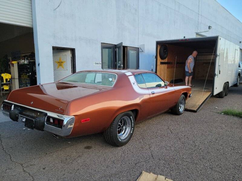

So made it back down to AZ to finish the stripes and finish up odds and ends. Got there and the back of the shops roof had collapsed due to a roof leak and the mosoon that came through. Fortunately missed my car by a foot but needed to get it out of there so it was going home no matter how much I got done. I had prepped my cousin Rick that I might need him to come down to pick it up with his trailer. He hit the road Sat am.
First set back,
I went to start it up and it turned over, had fuel, but no spark. Started checking and narrowed it down to the Electronic Ignition Module. Replaced it and it fired right up.
Second set back,
Started working on the brakes, could not get them to bleed properly with the one man vaccum bleeder kit. Could not get them to pump up properly but had some brakes.
Trailer is on its way, started packing up the parts getting everything ready.
Pulled the car out of the bay. First time the car has moved under its own power since 1990.
Third set back. The trans was slipping too much could not get much movement out of her. Checked everything I could, added some more fluid and it got better but not 100%.
Finally got the trans to work well enough to move, got it in and strapped down.
We hit the road at 5 am the next day, 13 hours later we pulled up in front of my house. Unloaded and all the neighbors came out to see. They finally believed the car really existed, they had only heard about it but never seen it.
No, I am not in any of the pics. I got the car in the garage. Now just need to fix the brakes, check out the trans, put the new exhaust in, finish up the console install the radio and stuff. I will keep posting progress.
