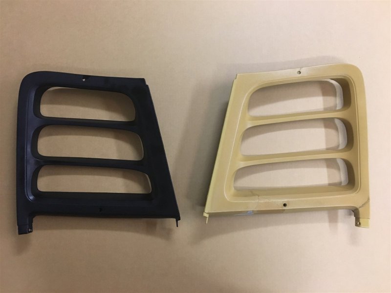

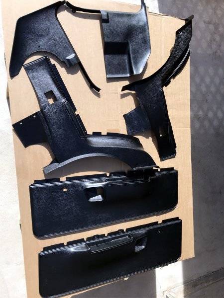

It is actually more of a semi-gloss. Satin is a bit more toward the mat finish. That is why I'd call it semi-gloss When I changed colors from gold to black I ended up spraying a cover coat of Dupli-Color Vinyl & Fabric Specialty Coating (mat black) followed by a light coat of the gloss. Used their Adhesion Promoter as the foundation. Here is how things look.
View attachment 1652427 View attachment 1652429
Thanks. I used a Satin and thought it looked a little too shiny, maybe not.
Semi Gloss and have seen a few in Gloss.
