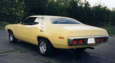

Even though they look similar, a close inspection and/or side by side (pun somewhat intended) will reveal (also somewhat intended) that the 71/72 styling line- especially over the wheel arch- is a wedge shape profile giving the appearance that the upper body is stacked on top of the lower and the 73/74 is more of a chamfer.
Also note that the 71/72 line continues along the panel both in front of and behind the arch, whereas the 73/74 blends back in to the radius of the panel top to bottom. The 73/74 rear quarter roll in to the trunk drop-off is also extreme and nearly horizontal on the bottom.

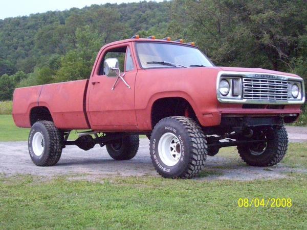

There's a "best kept secret" that says a 72-80 Dodge truck fender wheel arch has the same profile as the 73/74 RR/Satellite quarter arch, and can be used for a patch.
I own both vehicles and it certainly looks possible although I haven't measured it.
Best illustrations I could find quickly-
...and here's a truck.
Hmmm. in that pic the truck fender looks more like the 71/72 profile.

You mean like this??
http://raybuck.com/i-67489-1972-80-dodge-pickup-upper-rear-wheel-arch-fleetside-only-driver-side.html
The more I've thought and looked- I'll retract the word "chamfer" and substitute "fillet".
The truck fender is more of a fillet, but the extension onto the dog leg threw me.
Looks like you sure could use the very top, and a lot of these cars rust out there.
Would you be so kind to do some measuring on the pickup front fenders for I have had friends looking west and in the deep south for some LKQ quarter panels with no luck at all.
