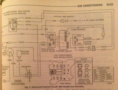

73 b body blowers have a ground and power feed (usually green but have seen red) coming from the harness along the fire wall.
hope this helps

Thanks very much 73 Runner, that has been real helpful a i don't have a factory manual to consult.
Sure looks as if the main feed from the blower exits on the engine bay side whereas my blower motor has no wires showing, hence my query.
Much appreciated!
Blower should get one individual spade male terminal on green wire ( reds are replacement blowers ) and one eyelet terminal for ground, black wire, attached to firewall. Usually to one of the heater/AC housing studs/nuts
wire goes through engine bay allong with engine harness but attached to tranny plug ( the only cavity left on it )
When AC, Compressor clutch feeds is on the only cavity left on engine harness itself, and is dark blue
on 71s both wires were at tranny harness plug, since these didn't got the NSS ground into the cab, but 72/74s did, to the seatbelt warning system ( 71s got this light with time delay flasher control )
When AC on 74s, both wires are through wirewall with a grommet, like first pic shown, then a T plug to be attached the rest of harness, due the lack of cavities available on 74s for interlock system added wires

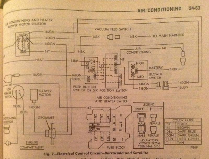

Do some of these cars have a wiring set up which is all under the dash? Additionally despite the useful diagram above I can find no evidence (at first glance) of the heater motor resistor pack. All new clues welcome!

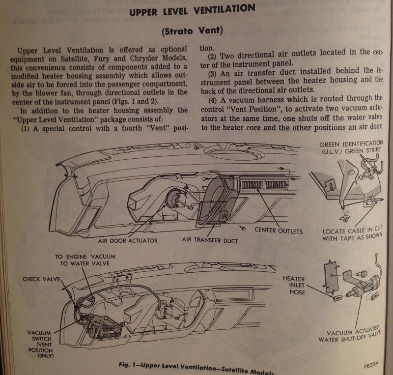

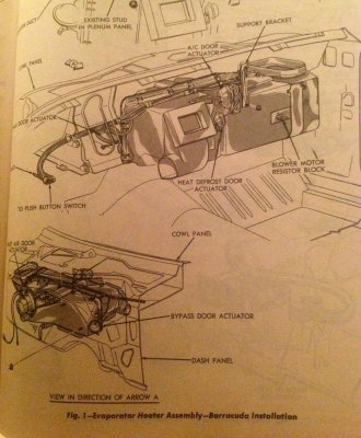

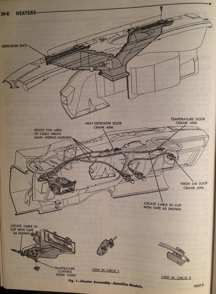

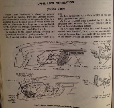

Here is the Service Manual illustrations and instructions for the heater and strato vent system.
"Strato Vent" was an option on non a/c cars and is just the two center vents. It mounts to a modified heater housing.
This is the base no charge standard heater

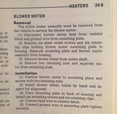

Looks like the blower is mounted inside the housing and accessed from inside.
Hope this gets it for you... Let us know how it goes.
Thanks so much! That is exactly what I have and recognise and that answers my questions. I have a list of things to do and this is one so I will report back in due course. I've also ordered that factory manual for my car which will be a huge help.
Time for an update. As expected, I traced the lack of power to the blower to the resistor. Now I have. A lower and a new problem instead!
