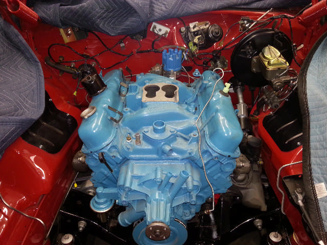

I'm just completing a nut and bold full resto on my numbers 1 of 396 '73 Charger 340/4spd and I'm trying to figure out EXACTLY where the TQ solenoid wire plugged into. I'm surprised I didn't tag it or have a pic of it.
Any help would be greatly appreciated, I'm at a road block with this.

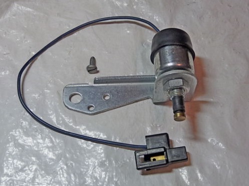

Do you mean the item front of the carb that kicks in when you flip on the A/C?
I noticed you don't have A/C ... beautiful job BTW.
I can send you pics if that is what you mean.
Thanks for the kudos, appreciate it.

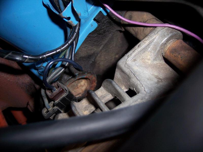

Right NO A/C. Your pic is it. I'm thinking that this plugs into the F "Field" terminal of alternator, then the plug that went into the Field terminal of alternator plugs into this clip. I'm 99% sure, just want to verify.
Thanks,
Dave
Pic another member sent me because I asked the same question. Is this correct?
