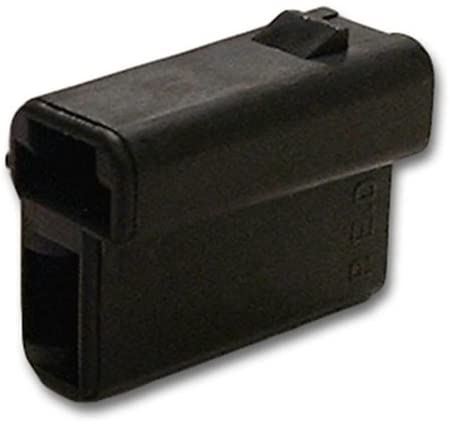

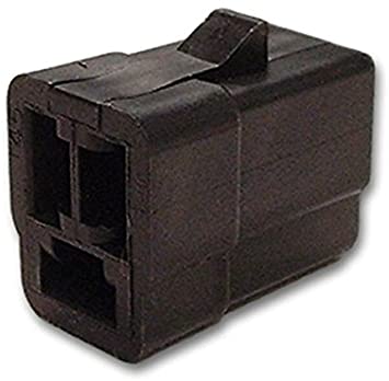

Stereo radios are 4 transistors and 3 wires plug (violet, green and black) while Mono is 2 transistors and 2 wires (green and black). This of course changes the plug...
3 ways on Stereo:
vs 2 ways on Mono:

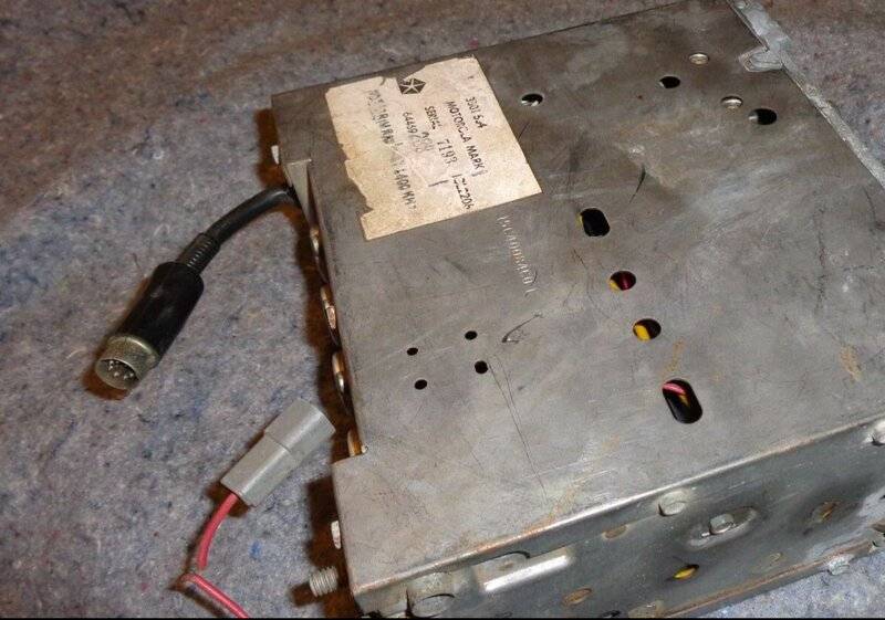

Then, aside the Mono and Stereo setup, the Radios with the Cassette player option ( called as MULTIPLEXER on Parts Manual ) got a pigtail with 5 pin DIN connector for the cassette player connection.
These can be Stereo or Mono too. Even AM or AM/FM.
This connection can be capped or not with a jumper plug depending if the car was finally equipped with the cassette player or not.

-you can just feed the front speaker as the Mono setup was made without any extra option... matching green and black wires between Radio and Dash harness. Violet wire will keep unused. You can replace either of both plugs and match them. Change the 3 ways plug on the dash harness with a two ways one, and the violet wire will be hanging around OR replace the two ways plug on the radio pigtail for the 3 ways one, and install green and black wires on the cavities to match the dash harness. One cavity will remain empty on this.

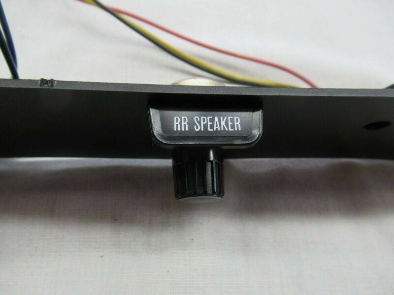

You can get a rear fader knob and harness to use the rear speaker correctly as a dual speaker setup on Mono radio. This was an option on some Mono cars ( AM and AM/FM ). The rear fader control goes into the map light/seatbelt light panel on the cluster "eyebrow" area of the dash.
