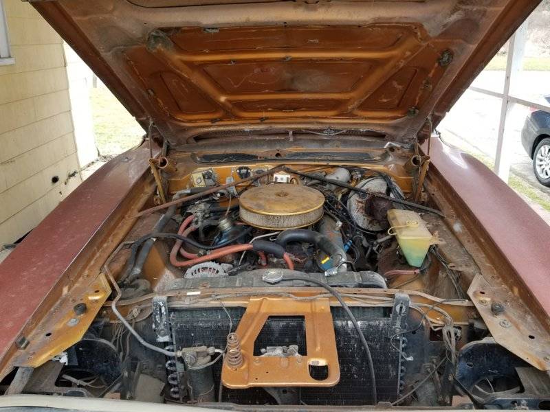

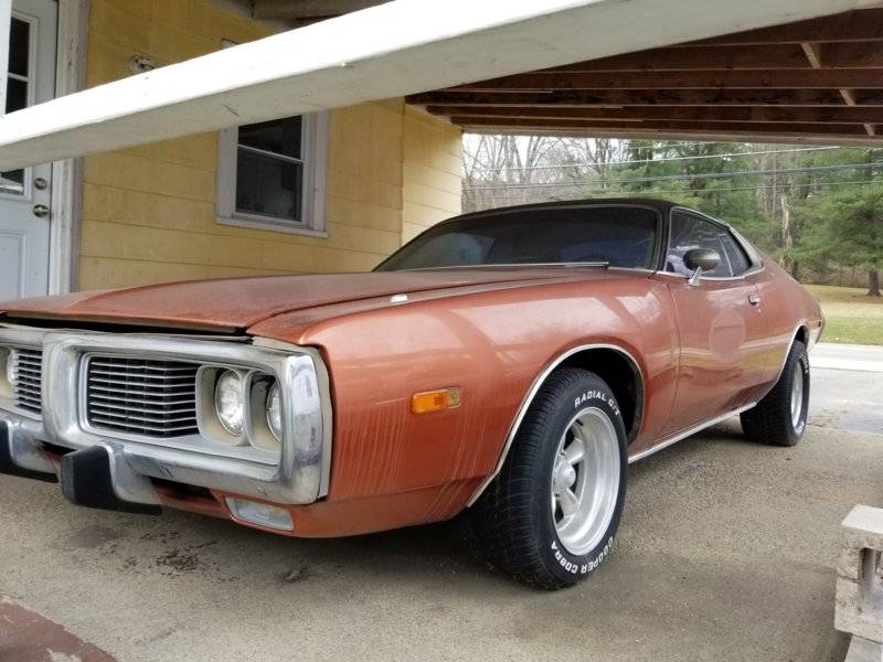

There is some rust starting, its deeper than it looks, meant to get a close upfrom the pics you need a master cylinder and a set of front disc brake pads And possibly a set of front rotors.
that pad looks like its been eating the D side rotor for awhile.

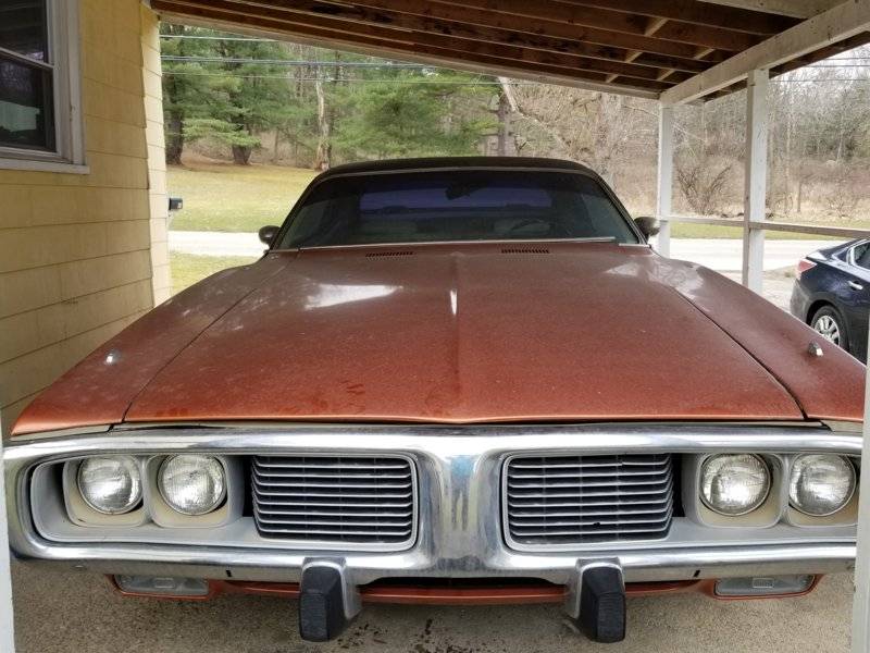

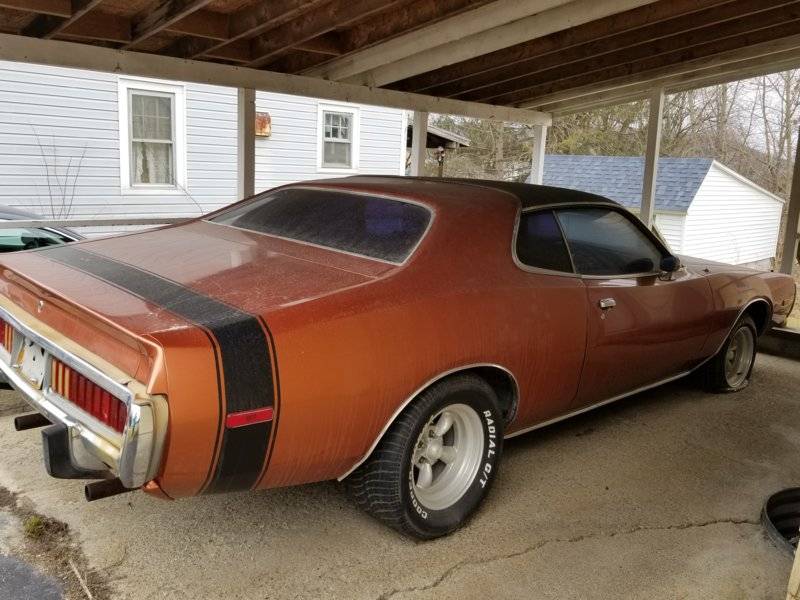

i cant tell much about the vinyl roof from here it doesnt look that bad.
the door ? skin? for what those scrapes? is there lower rust?
door looks okay to me ??
Definitely hasn't been driven in awhile. Brake fluid is pretty much gone so I have to go through all that before I can find out.Aztec was a package that had bronze paint and that interior pattern.

Rust under the top doesn't look too bad.
A LOT of time and effort or $$$ to fix.
Keep an eye on it, though if it starts to spread or get real high.
Brakes actually just look like it hasn't been driven in a while, although it does look like the pad material might be thin (although it's a bad angle to judge)
How does the pedal feel when the car is running?
Brakes are actually relatively easy to do although they intimidate a lot of people.

Thanks for the link. I was checking out a classic industries kit and noticed they have a couple of different options depending if the vehicle is disc/drum. Does it really matter?Booster and master cylinder: https://www.summitracing.com/parts/sum-760194/year/1973/make/dodge/model/charger
