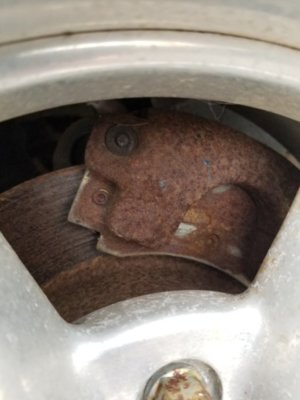

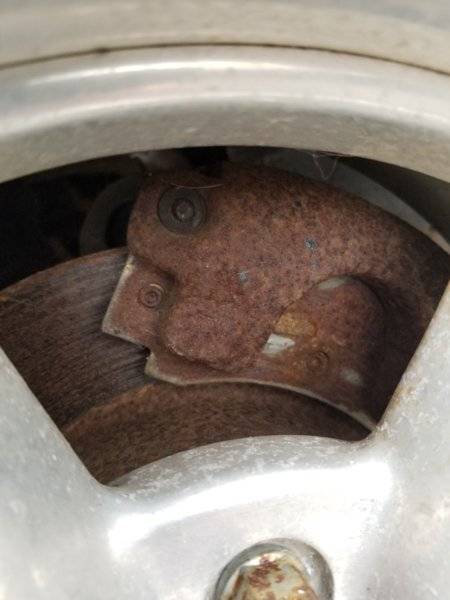

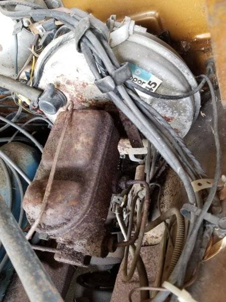

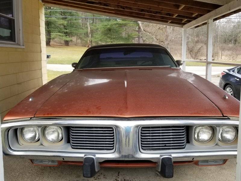

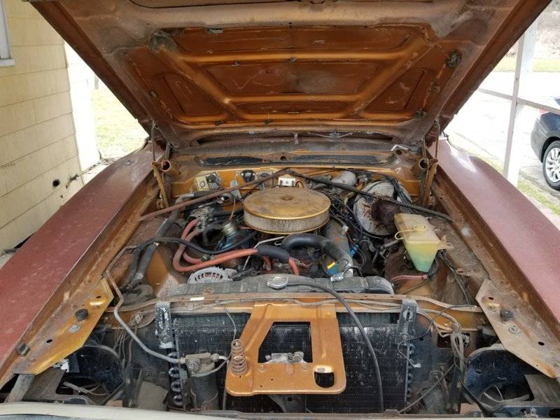

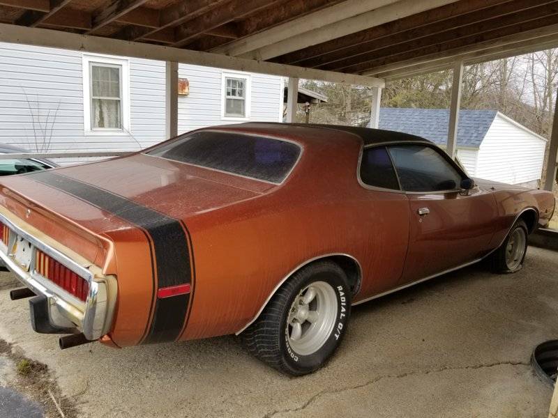

Any ideas how best to proceed with restoring? The perfectionist in me says tear it down and do a full sand and restore, but the realist in me says I don't have the skills or time for that and it will sit in pieces until I have to sell it as junked like the other one we had. This one just needs some brake work and wiper assembly and I can drive it, worried about the rust though.

and also hey check out the front K frame Bushings << under your car.
they literally are rubber bushing the factory attached the engine cradle to the body of your car with.
these are notorious for splitting,dry rotting and literally falling to pieces.
replace with Solid spacers and never look back.
inspect closely those mount areas in body for Rust/Rot as well.
i have parted out chargers over the years because of too much rot in those areas.

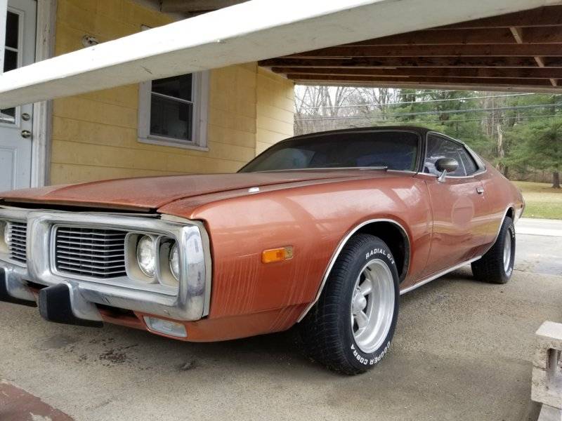

NICE!She needs a wash and some love, but she's mine
