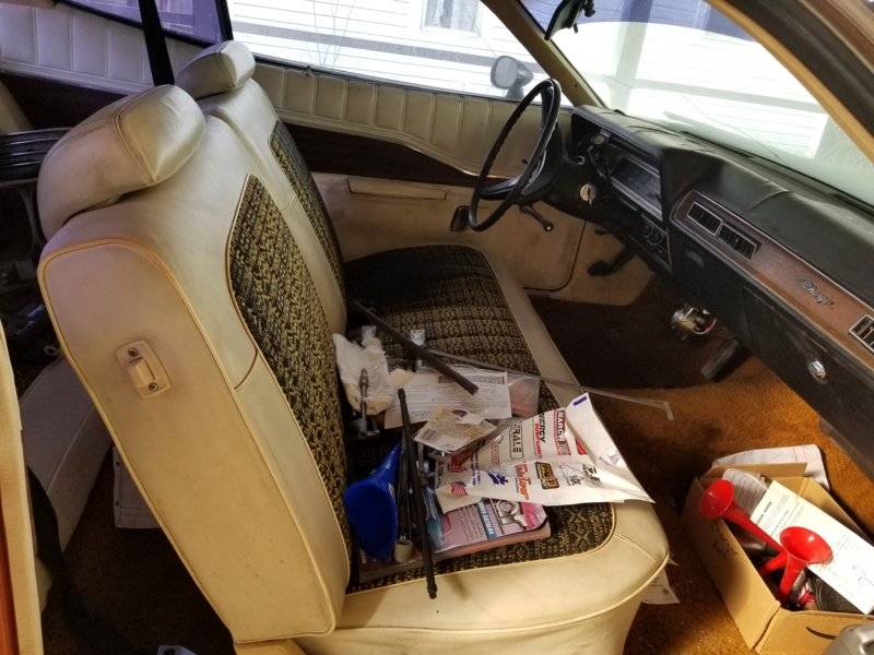

That could be an Aztec car.
Are the seats cloth with a square pinwheel kind of pattern?

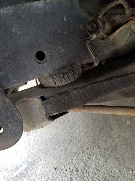

and also hey check out the front K frame Bushings << under your car.
they literally are rubber bushing the factory attached the engine cradle to the body of your car with.
these are notorious for splitting,dry rotting and literally falling to pieces.
replace with Solid spacers and never look back.
inspect closely those mount areas in body for Rust/Rot as well.
i have parted out chargers over the years because of too much rot in those areas.
Best wishes to you and hope any of this helps.
Is that the bushing you are talking about?

Aztec was a package that had bronze paint and that interior pattern.
not super desirable but somewhat rare and neat

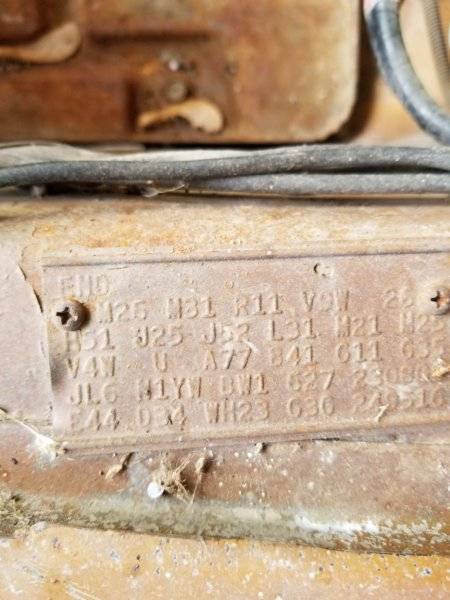

...and you can enter the numbers on that fender tag into the fender tag decoder on mymopar.com as referenced above and find out a lot of the things your car was built with.

Agree on frame to K member ISO bushings looking not great but OK.
Look at the ones on the rear (there are 4 total 2 in front and 2 in back of the front wheel), and look at the "fish plates" that reinforce the frame where they bolt together.
I've seen more than a few 73/74 cars rust between the frame and those plates.
No fun fixing that.
