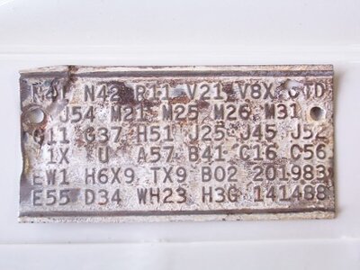

Here's a decode for the 73 Charger Rallye(mine)
Code
Description
E55
340-4 Barrel 69-73
D34
TorqueFlite Automatic Transmission
WH23
W = Dodge Coronet / Charger
H = High
23 = 2 Door Hardtop
H3G
H = 340 240HP(net) 1-4BBL 8 CYL 5.6L
3 = 1973
G = St. Louis, MO, USA
141488
Sequence Number '141488'
EW1
Paint Code: White / Alpine White
H6X9
Trim Grade/Style/Color
H = High
6 = Vinyl Bucket Seats
X9 = Black
TX9
Upper Door Frame: Black / Black Velvet
B02
Date Built: 11 / 02 / 1972
201983
Order Number: 201983
V1X
Roof Type OR Color: Full Vinyl Top - Black
U
Built to Specifications for USA Order
A57
Challenger / Charger - Rallye
B41
Front Disc Brakes Some Yrs. Power
C16
Console w/ Buckets
C56
Bucket Seats 1972 up
G11
Tinted Glass All
G37
Left Hand Remote, Right Hand Manual Chrome Mirrors
H51
Single Air /w Heater
J25
3 Speed Variable Wipers
J45
Hood Tie Down Pins
J52
Inside Hood Release
J54
Hood Insulating Pad
M21
Roof Drip Rail Moldings
M25
Wide Sill Molding
M26
Wheel Lip Molding
M31
Belt & Hood Molding
N41
Duel Exhaust w/o Tips
N42
Chrome Duel Exhaust Tips
R11
Music Master Radio AM
V21
Performance Hood Treatment
V8X
Transverse Stripe - Black
CTD
Continue

Here is a pic of my tag. My car was built in St. Louis. The 340 was built in L.A. You can compare from my earlier post.
