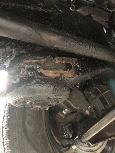

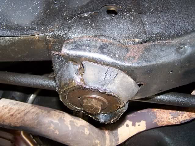

I just stumbled on your post. I have the same issue on my 74 Satellite, which is the same as yours. I’ve been searching to no avail, these pieces.
Would you consider making another pair, if so what would be the price? I live in Woodstock GA. Fortunately I have a complete NOS set of bushings, sleeves, and bolts.Attachd a picture of what it looks like . The first two are the right side (looks good) last picture is the left (driver’s side)bad. Thanks

Did you ever get it fixed I’m also in the same vote but I have the size of the hole just wondering how you did the patch I have an idea of cutting open the rail and extending the patch inside the k frame
