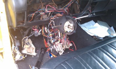

Holy Crap, why so many different ones, I bought all the same ones and they fit in all of them, thanks for the info, I had to take my dash out again ( guy I bought it from butchered the wiring, here is a pic....wow
