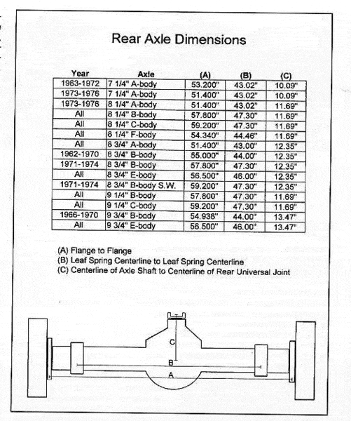

Does anyone know what other year/make rear end/ axle assembly will fit under a '73 Satellite other than the '73-'74 Roadrunner/Satellite.
I am looking for a bolt in with no mods needing to be done.
Here's a start...
Year Axle Type (A) (B) (C)
1963 - 1972 7 1/4" A-Body 53.200" 43.02" 10.09"
1973 - 1976 7 1/4" A-Body 51.400" 43.02" 10.09"
All 7 1/4" F/J/M-Body 54.340" 44.46" 10.09"
1973 - 1976 8 1/4" A-Body 51.400" 43.02" 11.69"
All 8 1/4" B/R-Body 57.800" 47.30" 11.69"
All 8 1/4" C-Body 59.200" 47.30" 11.69"
All 8 1/4" F/J/M-Body 54.340" 44.46" 11.69"
All 8 3/4" A-Body 51.400" 43.00" 12.35"
1962 - 1970 8 3/4" B-Body 55.000" 44.00" 12.35"
1971 - 1974 8 3/4" B-Body 57.800" 47.30" 12.35"
1971 - 1974 8 3/4" B-Body S.W. 59.200" 47.30" 12.35"
All 8 3/4" E-Body 56.500" 46.00" 12.35"
All 9 1/4" B/R-Body 57.800" 47.30" 11.69"
All 9 1/4" C-Body 59.200" 47.30" 11.69"
1966 - 1970 9 3/4" B-Body 54.936" 44.00" 13.47"
All 9 3/4" E-Body 56.500" 46.00" 13.47"
http://www.moparts.org/Tech/Archive/axle/17.html
Thanks guys! That should help while searching the salvage yards. Need to find one to rebuild with at least 3.55 gears and pull this 2.72 rear end out.
