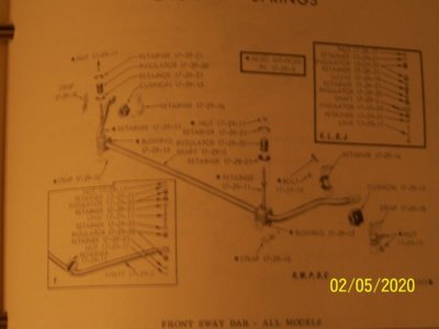

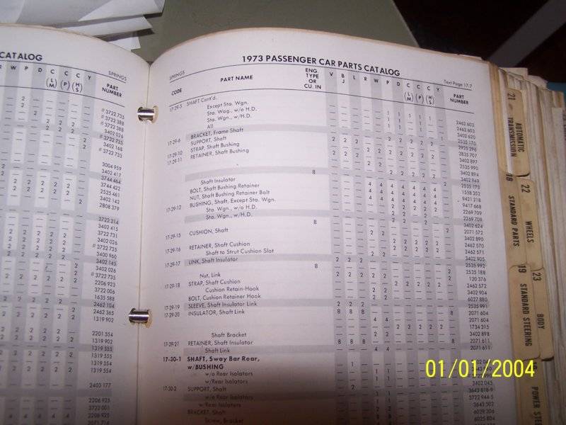

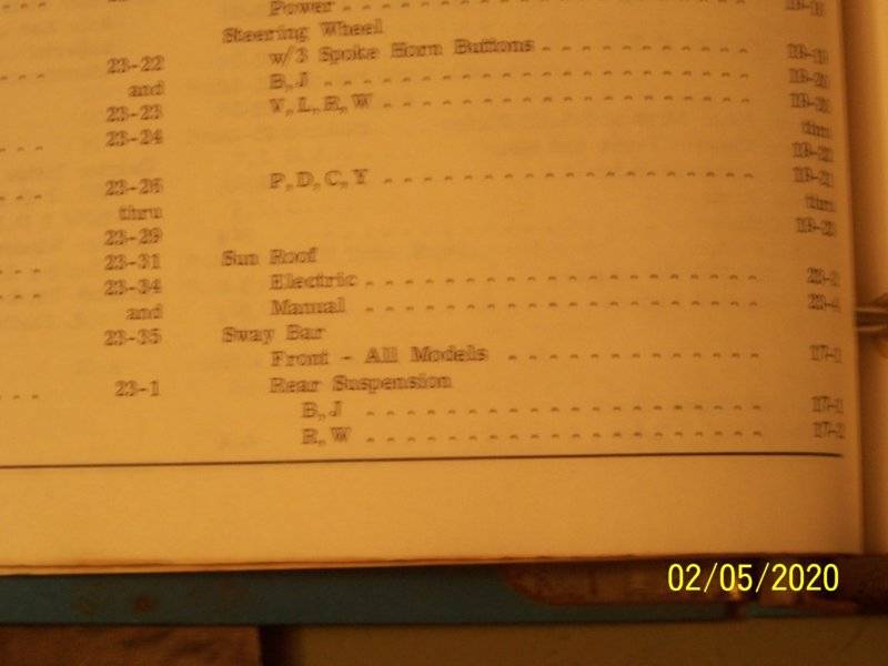

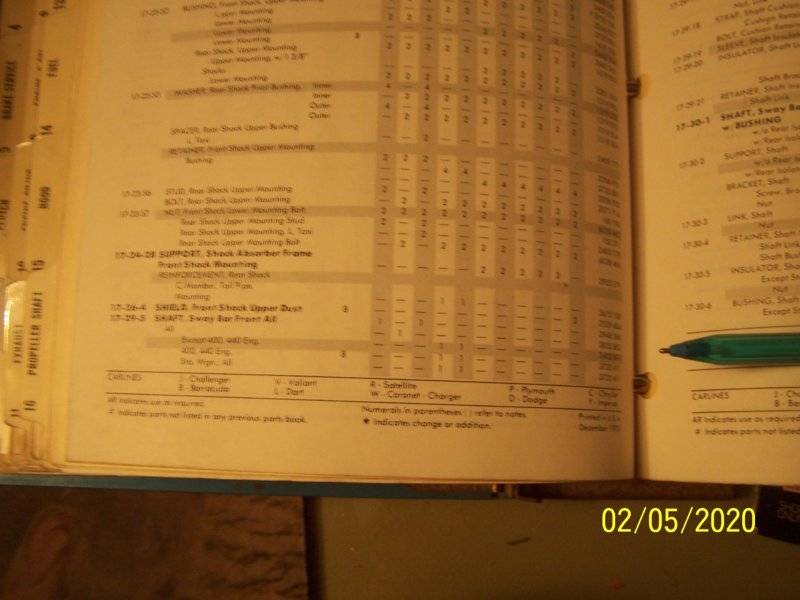

Sorry 340 6pack, I just got home. According to the book under the POLICE-TAXI section for Sway Bar Front-All models it refers to section 17-1 This section lists the shaft as 17-29-5 Going to that section your part number for a 318 satellite is 3402 891
If it had a 400,440 eng. then 3722 411 Without looking further maybe the 441 is a 1" bar but I don't know that as my book only gives the part number not the specifics. Hope this helps.

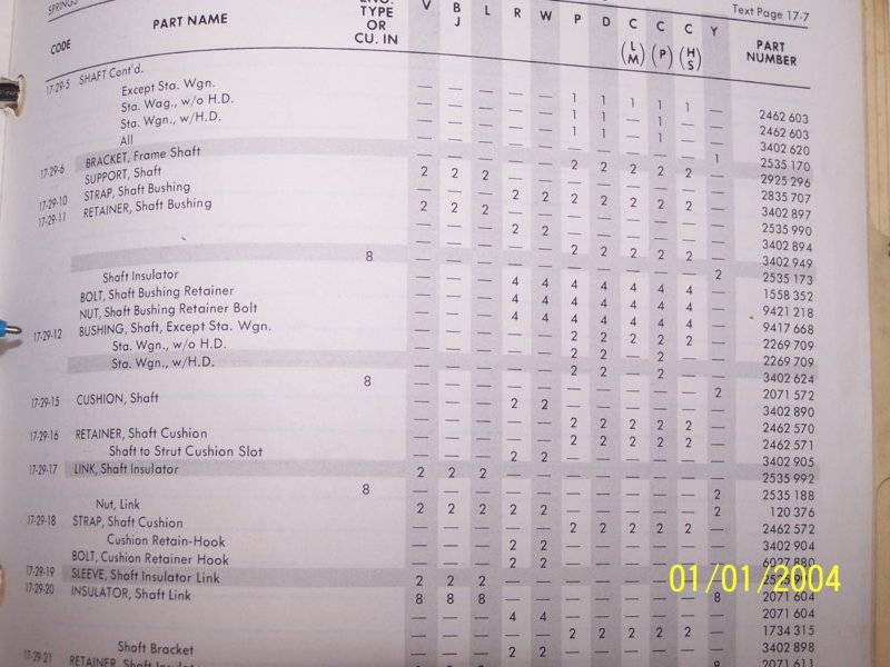

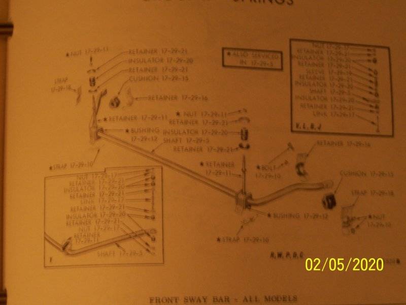

Opps, forgot to include the part number for the Bushing, shaft except sta. wgn. # 2269 709 for all Plymouth
this bushing number takes me to the size that I have. I'm trying to find out what size the big block bar number is now.
The only other number shown is for Sta. Wgn. W/H.D. That number is 3402 624

Something wierd is going on here. That number takes me to the same size of bushing. Thanks for looking for me. I think that I will buy some universal 1" sway bar bushings and see if I can get lucky and find some that I can make work. If not I may have to get a new sway bar kit and put it on. Thanks again for your time and help.
