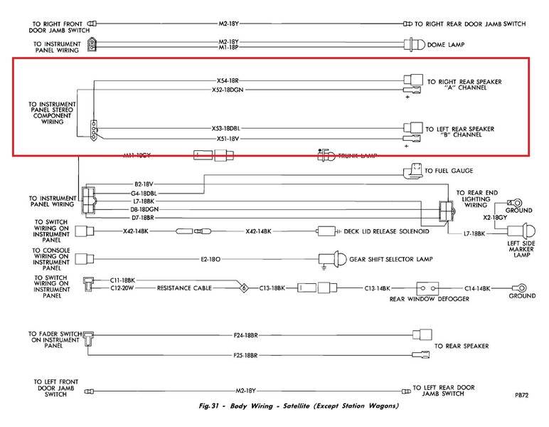

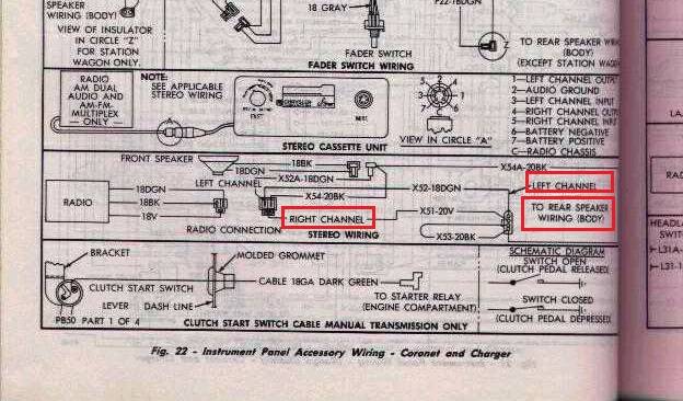

Just wondering... nothing to say about the wiring diagram showing dual rear speakers setup?
Not seeing anything in your ’71 Dodge diagram showing both left & right channel “dual rear speakers”. Nothing in the ’71 Plymouth diagrams indicates a package shelf “stereo” speaker option, never seen it.
Just showing what I found. Not saying who is right or wrong
Ok, interesting, has anyone actually seen this option? Order code?
These diagrams are not in the ’72 manuals, nothing listed as available in the ’72 order lists other than a single rear speaker.
