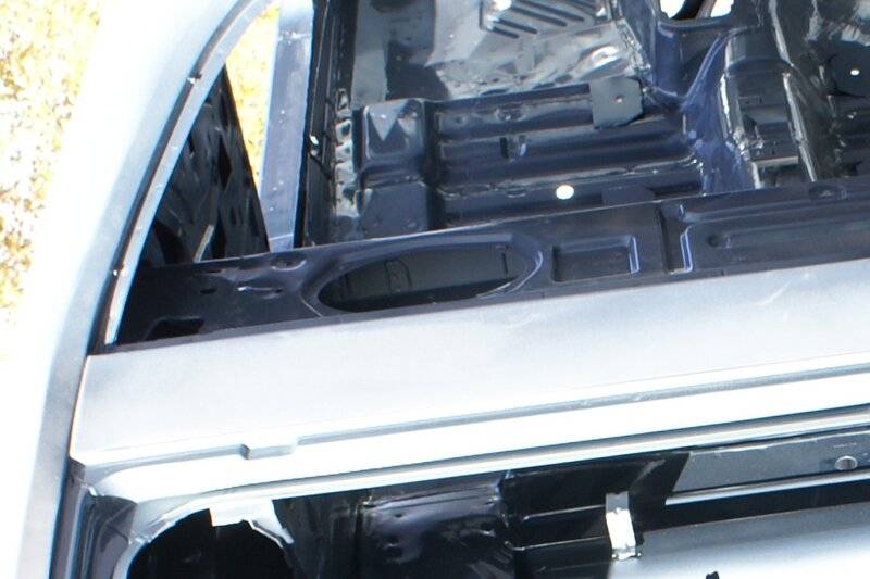

So stereo on 1973 b-bodies was apparently one front dash speaker and one speaker on the rear package shelf. There are two factory oval cut outs on my car's package shelf, but the right one is the only one that is recessed and has holes punched for a 6X9 speaker, so would that have been the location for the second speaker then? If so, would the speaker wires have been run down the right side - instead of the left side like the tail light wiring harness - since that would be the shortest route to go with them?

Restoration? From the factory in ’73, no option routed both left and right speaker channel wiring to the package shelf on a 2-door B-body. The right-side opening would have been for an optional rear window defrost blower. C-bodies from around that time that had true stereo rear speakers had the wiring for both channels loomed together from the factory.

From the factory, the single rear speaker would have been a 5x7” and mounted on the left side. The right side 6x9” opening present on these B-bodies of this time would have been to accommodate the defrost blower factory option or an aftermarket speaker. Many Chrysler models from this period had 6x9” openings stamped into the package shelfs with no 6x9” factory speaker options available.

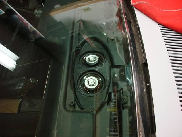

I put a dual speaker setup in my 71 SB front and a 5x7 and 6x9 in back for my RetroSound radio. Works for me.
Lol, you didn’t put that custom made dual speaker mounting in your car. That picture is of a modified OE 4x10 speaker frame in my RR/GTX. The build thread linked has some other shots of how I did my rear speakers, notably grafting in another 6x9 opening on the left side.

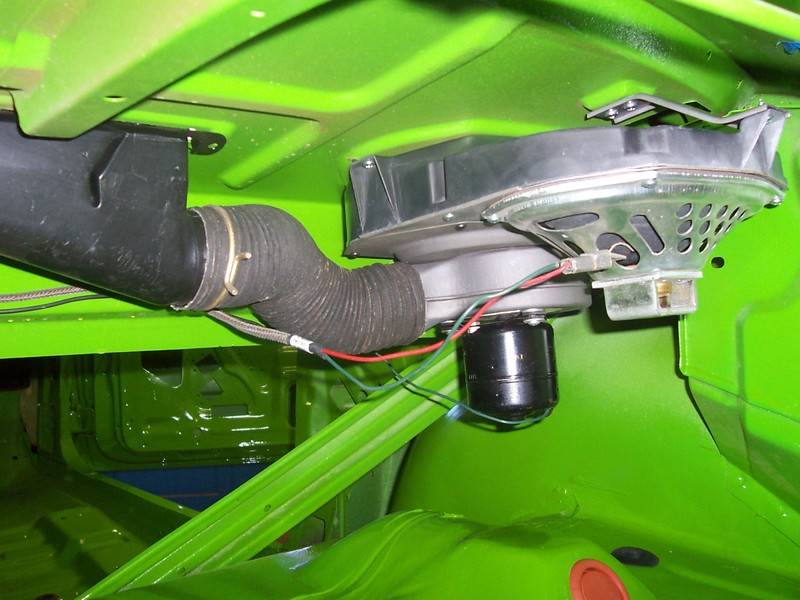

Well, most 73s came with a rear defrosted that frankly didn't work well. The idea was to suck
warmed air from the cabin and blow it on the window to defrost. Which clearly doesn't work if the car is still cold inside.
To accommodate this problem for a 2 speaker system Chrysler cam up with a more ridiculous idea of a bracket as pictured.
The last picture is my solution since this bracket is rare and if you CAN find one you'll need to refinance your home.
Since my car is not driven in cold weather it doesn't matter anyway.

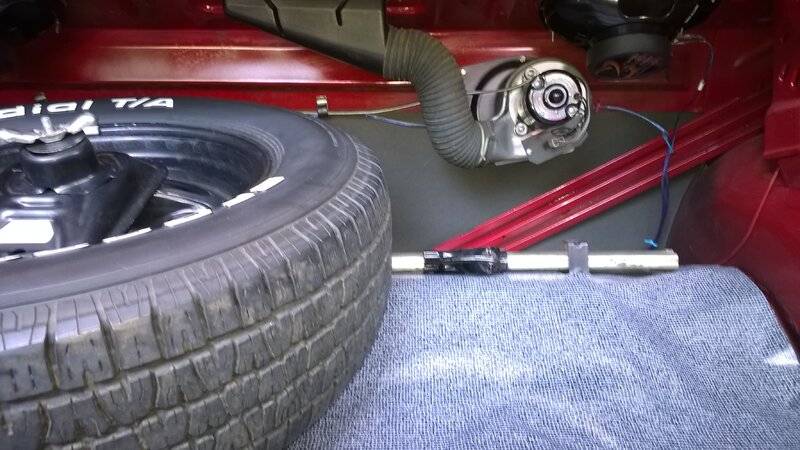

I did an identical blower modification on my ’70 Road Runner back in the seventies when all of those optional parts were readily available at the local wrecking yards dirt cheap. I recall even cutting a hole in the seat partition to draw air in from in and around the seat. As mentioned, not very effective system overall when it was really needed.
Some other reference shots,

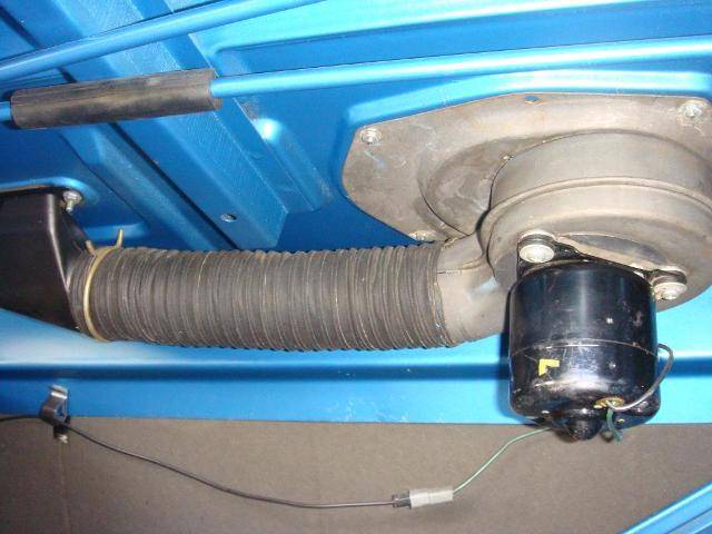

View attachment 1070576 View attachment 1070585

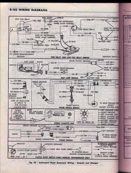

ONE WIRE to the blower ? it should get two... one black and one white every one for each speed, to a resistor mounted on blower case.
Yea, the blue car shot is reference only, don't know what model car, may not be a '71-74. Earlier versions were single speed IIRC.

When I made mine, around ’07 or so, wasn’t aware of any commercially available mountings then. Just reworked an old speaker frame, angled slightly outward hoping to get some separation in the reflections off the glass.
