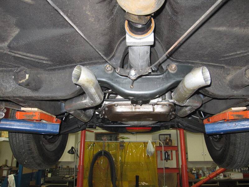

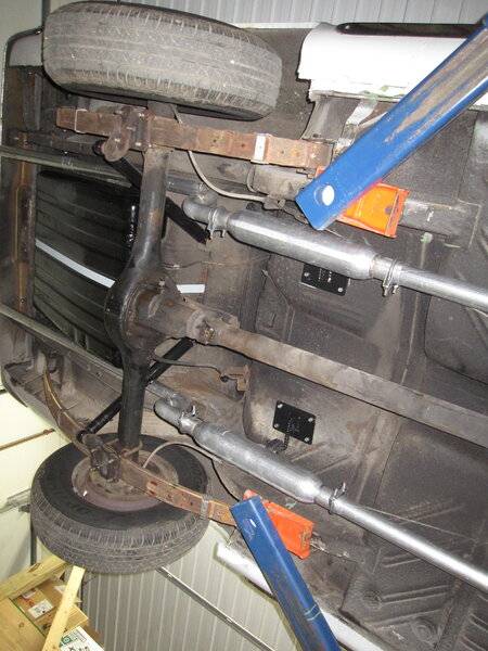

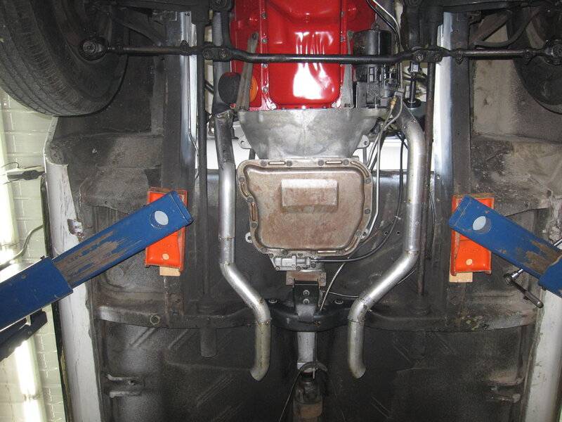

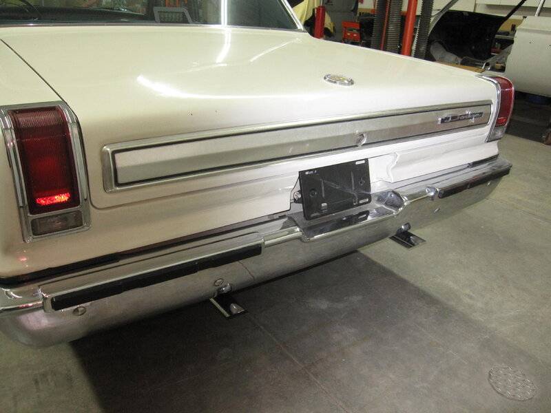

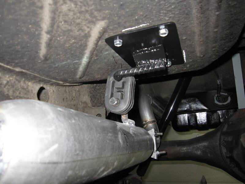

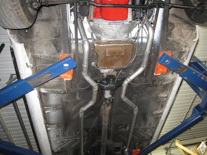

Can you weld/fabricate? Build your own. I used 2" on my 65 318 with cheap glass packs-sounds great!
Mike

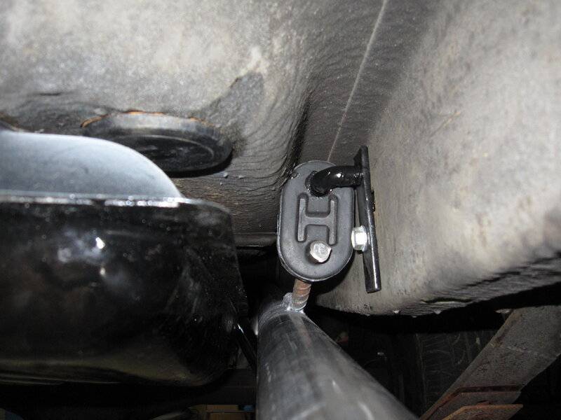

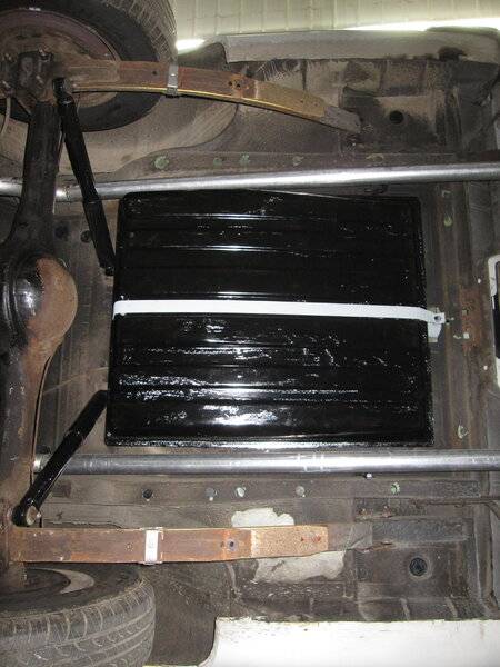

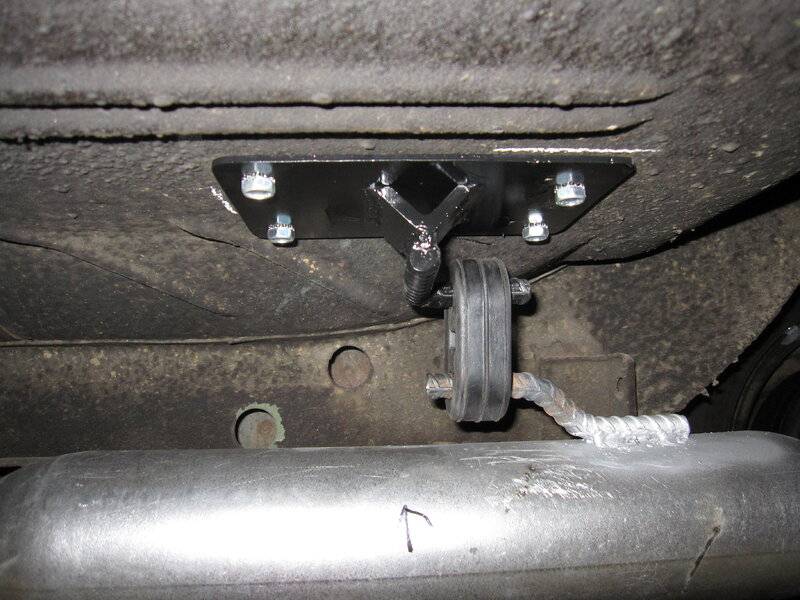

Hangers are Chrysler mini van. Use 1/2" round stock for hanging. I bolted plates to the floor under the back seat and OEM holes for tailpipes.
Mike
