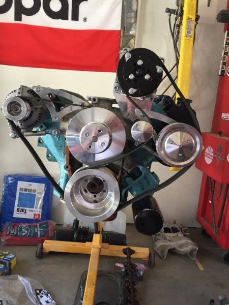

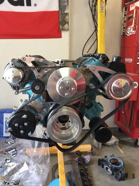

I have the beast set up, but I modified to have the ac down low.
E50ADE5F-2D91-4CFF-ADC0-A0B4CBDA0542.jpeg A33AEC81-65A2-4723-812E-BA9FBBADE076.jpeg
As far as water pump outlet stock big blocks from 73-74 have the outlet on the passenger side
I had to make the bracket for the rear mounting of the compressor and used the fuel pump mounting location. I ended up ditching the mechanical fan cause I couldn’t keep low speed/idiling temperature below 215. So I went with electric dual fans from Derale, now all is good. Just play around with it, see what you like. You might come up with something better than I did.
