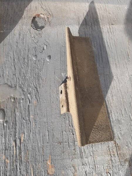

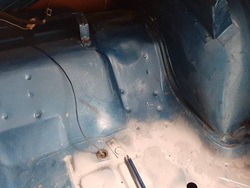

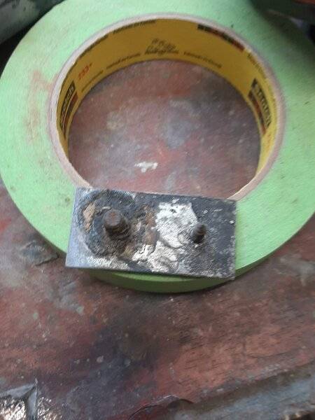

Anyone know what this trunk bracket is for? Located next to where the fuel sending unit wire comes into the trunk. The screwdriver is pointing to the bracket. Nothing is attached to the underside. Thanks.
Terry
It is used to hold a heat shield under the trunk that protects the fuel hose.
Yes, that's it. They aren't available new, just used. Or, you could fab your own.
My car doesn't have it. Nor the bracket or the shield. Not even the hole for the bracket LOL
