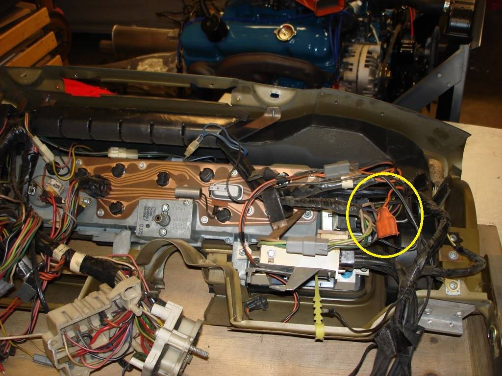

In a nutshell, there are two basic variations of the ’71-74 Rallye cluster, with a tach (or clock) and without. Minor variations for the model years. The original tach and clock are physically interchangeable. The Rallye dash harnesses are not the same as the standard cluster, basically the connections to the cluster are different, and wiper switch location is different. That said, with some electrical skills the standard dash harness can be reworked to support a Rallye cluster.

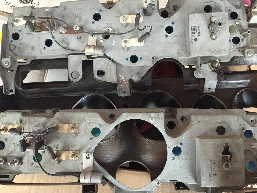

"THe connections are different..." meaning the plastic male/female connectors at the end of the wires? I just need to use existing wires and buy correct end connectors to splice on?

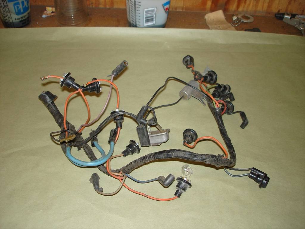

You will need these Rallye specific bulb sockets and connectors to start with.

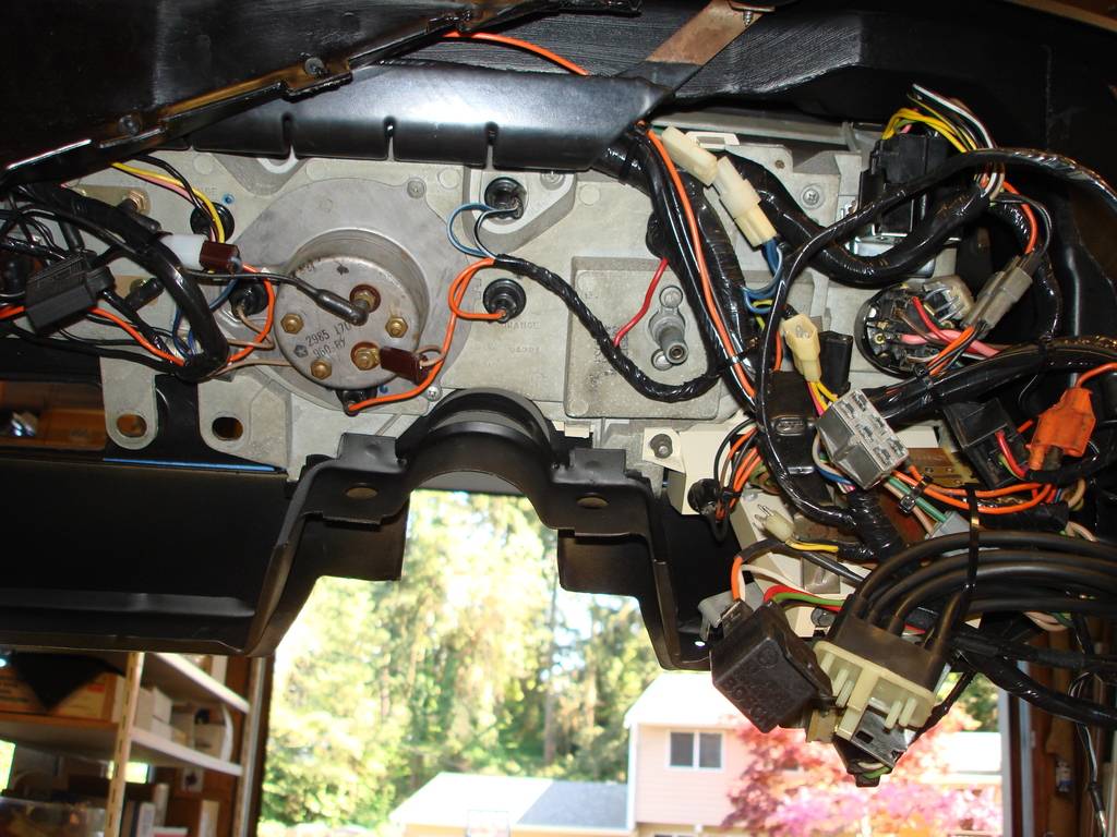

Standard cluster uses a circuit board for most of the lighting and gauge connections.
Rallye
Standard, disregard the circle.
It's all about the goes intos and the goes outtas. :) The wire for the fuel gauge of a standard dash also goes to the one on a Rally dash, but you may need to shorten or lengthen said wire to make if fit. The important thing is to have a roll of masking tape nearby, and make a label for each wire you take off. Then look for where these same locations are on the Rallye cluster and splice new wires in, or shorten, as needed.
