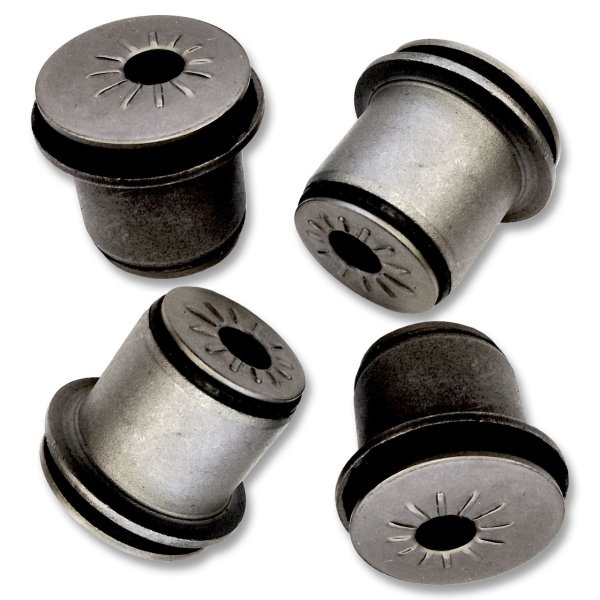

Can you elaborate on the offset bushings? My threads are bad too, but my body guy is adverse to welding in ball joints. Pretty sure his plan would be to cut out the hole for the ball joint and weld in another plate and tap the hole. Not sure if that’s his plan but I’m guessing. Up to this point we were going with firm feel. I need to figure out another option.

The below picture isn't necessarily Mopar - I just grabbed it quickly from the internet...
...but the idea is the holes are offset in the bushing. When installing them, the bushing can be installed in an orientation that gives you more caster (which is what you need on your old 74).
They are cheap and they work.

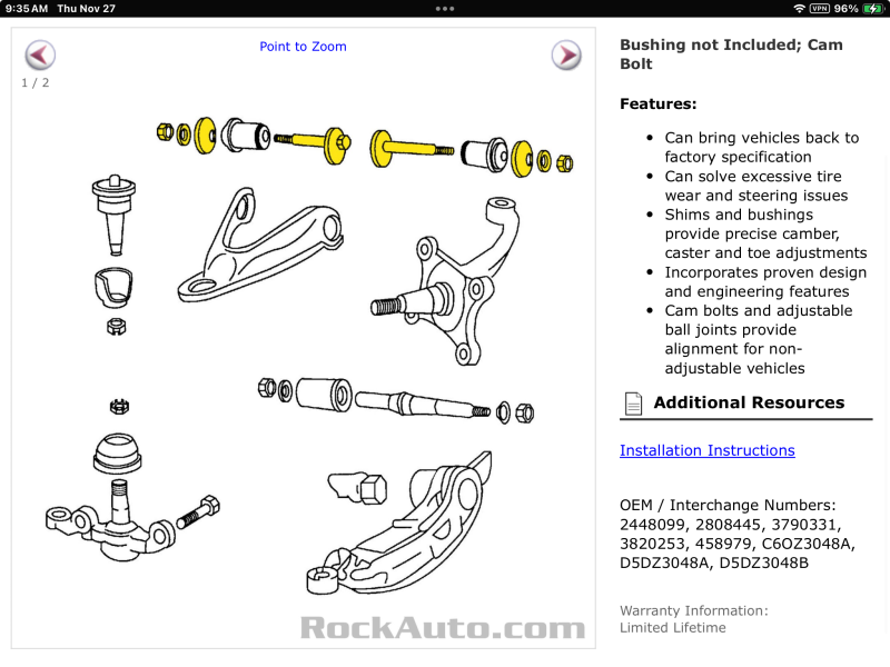

73-74 models don't use cam bolts. There are slots in the k member.
I found those listed on Rock Auto specifically for my 74, so apparently Rock Auto has it wrong.

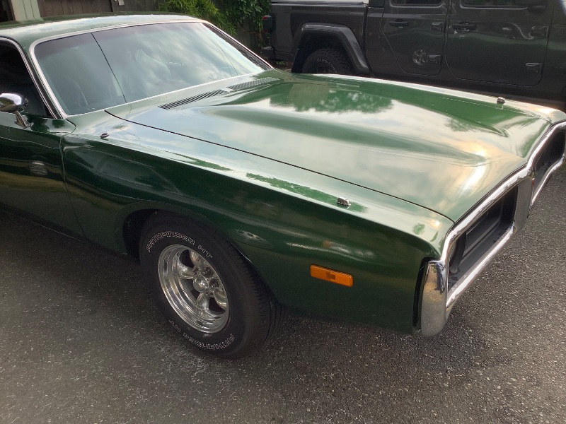

I recently lowered the stance on my 74 Charger and had a well respected shop do a thorough alignment and there was no problem getting 3.5 caster on the old stock upper control arms.
And the thrust angle is very close so nothing needs attention there. Drives like a completely different car now. I finally decided enough fun with the higher stance which was always challenging to get good even tire wear and some decent manners.
On my 73, I just used the original arms and installed offset bushings.
I could have sworn I used offset bushing on my 73, but it was a long time ago, and I have installed a few offset bushings in a number of cars - perhaps I got them confused. Apologies.
