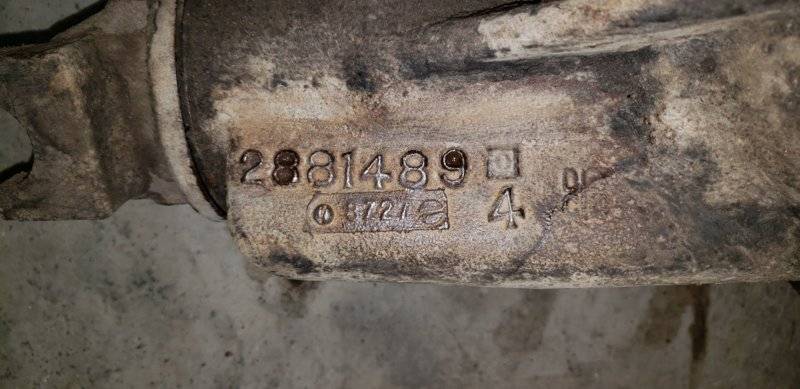

Just picked up a 489 3.23 sur grip center section, I read its a straight swap on my 8 3/4 , its for
my 70 charger 500,
Question is, the 489 has a large yoke, the 741 is pretty small compared to the 489, I see there are combo U joints which Ive used in the past on other cars,
Are BB drive shafts U joints larger? I'm thinking my current drive shaft is maybe off of a 318 car,
Sooo my origional setup is 383 4 speed to 741 case,
Going to 383 4 speed to 489 case,
Should I be looking for a BB drive shaft? or just use the smaller one I currently have with a combo U joint?

Also your 70’ Charger did not come with a 741 center section. Somebody put that there in place of the (depending on the month your car was built) 742 or 489. But nonetheless, a combo u-joint will work just fine.

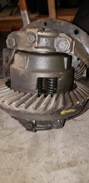

From what i gather i have the cone type surgrip, that use additive as well?

Yes, you will need the additive. Get the Ferd stuff, you’ll be good to go.
FORD
