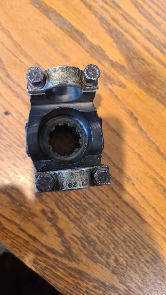

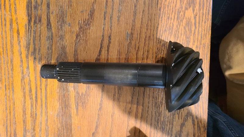

Ordered (online) a new 3.73 ring and pinion for my 741 case. Opened it up and found a 29 spline pinion, opposite of the existing10 spline yoke I was planning on using. New pinion has 7/8" thread and larger lock nut than the 10 spline.

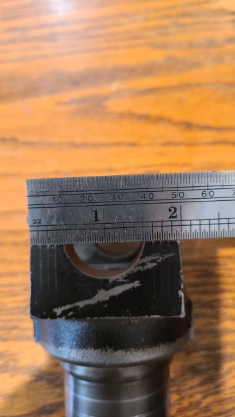

Measurement is 2-1/8".

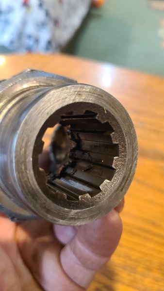

You have 2 1/8", 7260 yoke/u joint with 10 splines. That one uses the smaller nut on pinion 1 1/8 hex. The 29 spline will use the larger 1 1/4" nut. As mentioned above you can get them in either size. The yokes can go on any case as long as spline count matches.

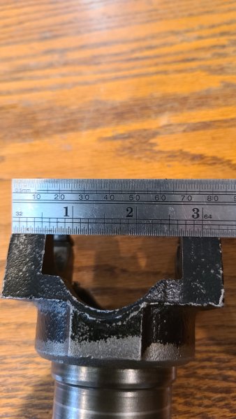

I would upgrade to the 7290 2 5/8 yoke if you are already buying one and use a criss cross u joint with 7260 2 1/8 to 7290 2 5/8 to mate to your existing driveshaft. If you ever need to upgrade driveshaft you already have the pinion yoke in place.
The ears on a 7260 driveshaft side will only take a pounding for a while then the caps will loosen.
I just had to replace my Charger's driveshaft this year. Drove all last year with the caps tacked in place. I have never had a issue with the 7290 joints in my Challenger.
