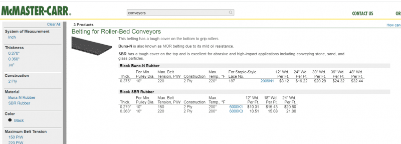

You could make something from conveyor belting:
