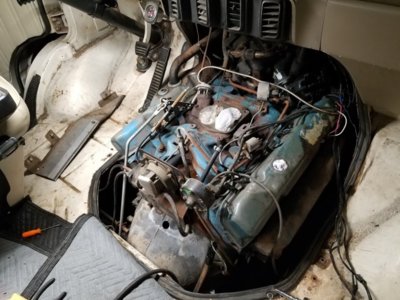

Hi! Long time reader, First time poster. I've been reading on this forum. and others like it (A, D bodies) forums. ETC.
(1)I have a Mopar 440 in a 21' Motorhome. It has a Thermo-Bog on top. It didn't run, Had no spark. and when I did get spark. it would leak fuel from the carb above the phenolic bowl (Top gasket)
(2) When I got it... Some guy that was an "electrician" by trade. Was trying to restore fire to the engine because it was not firing.. [Side story: This guy.. I called Sparky. Because he was good at making sparks. This guy was trying to swap MOPAR ign for GM HEI. He had no idea what he was doing. Couldn't get fire no matter what he tried... So I bought the whole thing and decided I would fix it myself... So I tore out all the wiring he did. and went back to the stock wiring harness. I checked the wiring diagram. And within an hour or two... I had fire. Weak fire.. But fire nonetheless]. Once I got fire.. It was weak.. I checked the coil. Secondary coil was 3K ohms low. So I got a new ACCEL coil that makes 42K volts. opposed to the 20K volts from the old coil.. The control module. was shot. So I got another one of those. Ballast was missing because Sparky thought it wasn't needed when using HEI. (Not sure... but I think the resistor is needed no matter what to keep the coil from overheating and dying) Got a good, hot spark. So I set it to 10* BTDC. Real loud hard pop. So I moved it back down to 8 like the valve cover and the book says.. This uses the Reluctor and coil type, not breaker point ignition. So I closed the gap of the coil down to 7 or 8 thousandths of an inch. Checked timing once more. Still good... So I don't think timing or ignition is my problem... I've only been wrenching nuts for about 10 years. I'm only 24.. And I am well aware of the problems that weak fire can cause...
(3) The thermobog was severely out of adjustment. (Sparky thought maybe it was fuel, Had no idea how to check for fire.... Idiot..) So badly out, that it wouldn't even idle in gear....The idle mix screws were WAY out. So I brought them in to 1.5 turns... With the newly rebuilt fire... I turned the key and it started... It stumbled and coughed a lot. and the exhaust was rotten just below the passenger exhaust manifold... It would die in gear. and the leak was still there.. So I took the carb off. and put on a carb from the highway patrol back in the 80s. Ran rich as a son of a bitch! So I said.. Well. Time for a rebuild... I got a rebuild for the original thermoquad. Took it apart... So I installed a new gasket. Upon installing the new gasket. I checked out the internal parts. Replaced the accelerator pump piston and the cap that goes in the end of it with the little ball in the brass. The floats were set at 1-12/32 and 1-8/32. So I set those back down to 28/32. I got it within 1/32 of spec. A smidge over. I figure a tiny bit over is better than a tiny bit under... (Thoughts? 1) I didn't have a gram scale to weigh the floats.. So I don't know if they're 8g or not.. but... I got it back together. It started within 5 seconds of cranking (Just to fill the bowls) Now it would still die in gear... But it would stay running longer in gear now! So now I'm thinking... Vacuum leak.. I start taking off hoses. confirming that they go where they are supposed to go (According to the emissions sticker that shows it) Nothing obvious (To me anyway... I've been messing with engines since I was a kid. My grandpa showed me everything I know) So I get to the choke pull off. I remove it's vacuum line. put my finger over the hole. Shift it into gear (Not sure what would cause me to do this.. but I did it anyway) and it runs in gear! I put the choke-pull off back on... continues to run in gear. Shut it down. start it back up.. it runs in gear! (Thoughts 2) Why would this cause it to run in gear? I introduced a vacuum leak when I took the hose off. Sealed the leak when I put my finger on it... Then put the hose back on. and no issues anymore... What would cause that?! The choke-pull off holds vacuum and the arm moves in and out with vacuum.... So it's working correctly I think...
(4) So now that there are exhaust pipes on it. on the way home from the exhaust shop.. I decided I would mess with it a bit.. Fire seemed legit.. So I figured FUEL would be the next step.. Idle mix is set with screws to highest vacuum. then backed off a tiny bit. (Correct?)
It didn't seem to have much power when accelerating (I've never driven a motorhome before... So maybe they are sluggish? But the engine sounded like my motorcycle when it's either drowning in fuel. or starving for fuel... So I figured.. It's probably Metering rods that control the mid-range.. So I moved them all the way down while holding the piston down, got to 1.5 turns UP from the point it STARTED moving.. It was WAY higher than this adjustment...about 5 turns UP from "baseline" So... While driving down the road.. I reached down there with a screwdriver and brought the rods UP, by turning clockwise, I gained a fair amount of performance from this..But it still feels like there is a "bog" while getting to WOT. If I just hold WOT, The 727 will downshift and the power comes alive. The "hiss" of the TQ goes away and it turns into a ROAR. It has VERY decent power at WOT. But it could take a bit more power IMO. Getting moving from a stop, it still lacks power, mid range still seems like not enough power.. Placing my hand over the choke does increase RPM. but I haven't tried that while driving to see if it makes more power. What adjustment procedure should I follow to get the factory power back out of this engine? I'm for the most part, VERY mechanically inclined... I rebuilt a 5 speed manual transmission in my garage floor on moving blankets. I also restored an 82 honda cb750K from nuts and bolts into a motorcycle that nobody has seen any part of but the tail-light. I know that this carb should be able to make the 440 SCREAM and it should make close to 370HP with STOCK. I just don't FEEL that in the seat when driving this motorhome. Mind you. it's heavy, but not loaded. all cabinets are empty, tanks are empty, and even some of the hardware is missing, (Leveling hardware, jacks, spare stuff, coach batteries, etc) So it's actually lighter than it will be once it's loaded.)
Sorry for the long post! Just trying to get most of what I've done out there so I can be critiqued on what I should have done or haven't done. Or done wrong. List of stuff done below for reference!
Currently. This motorhome is 2K miles away in California, and I'm in Missouri, I will be going back to work on it a bit more before attempting to bring it back here.
There is fluid coming from the mastercylinder of the brake/power steering booster thing. I think it's probably brake fluid. But my grandpa says trans fluid because he says it doesn't smell like brakes... I think it's brake fluid because that's where the master cylinder is for it... The other part of it controls steering.. sure... but that's only a vacuum booster there. the PS pump, and reservoir are both further down on the engine, I THINK!
Stuff I've done
Checked hoses for vacuum leak
Restored factory ignition module
Changed coil to hotter coil
Set reluctor gap
Set idle mix
Set Timing
Adjusted Metering rods while driving down the road for best power at the pedal
Voltage regulator lets 20V to battery, Reading spikes up and then down to 12.8 Battery voltage.
Changed Valve cover gaskets, Still leaking oil
New PCV valve, New Canister that goes into valve cover.
Broke off oil check tube that goes into oil pan, (Rotted through with hole from rust/heat?) How do I replace this? It was a steel line with a compression fitting screwed into the side of the oil pan.
Looking at videos on youtube of other RVs like mine, and thermoquads, it seems that my linkage isn't hooked up right. Pressing on the gas opens the butterflies, but I think the kickdown arm is supposed to be on the same post as the gas pedal.. Could this cause bog in mid-range? I don't think so.. but maybe some black-magic that the TQ holds inside might count on this being right?
Any ideas on what I should do or look at? I won't be able to look immediately. But in a few weeks I will be able to get back to it. And I want to be a little better prepared this time because I need to drive it 2K miles.
Thanks!! I see a LOT of friendly helpful people here!
