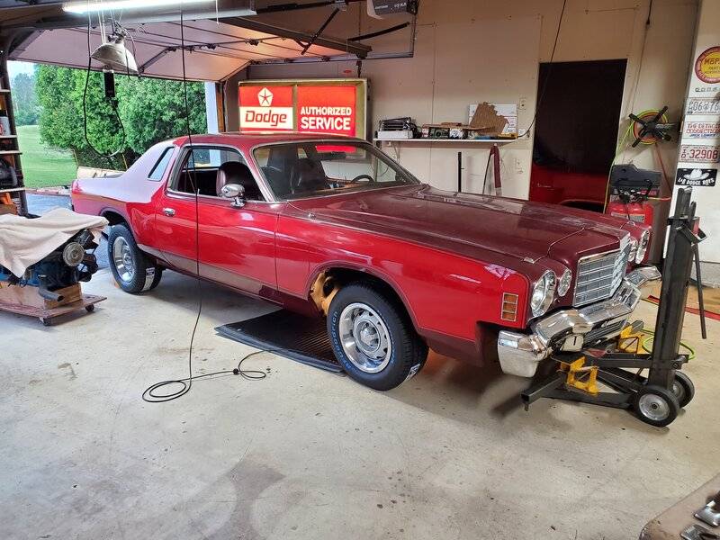

Adjust like a parking brake cable, if the brand new linings don't fall apart yer done.
Now it's ready for some miles after some years. Last time driven before just waking up was 1996 - break in motor before going to body shop.
Put a plate on the evil one, started shaking it down.
