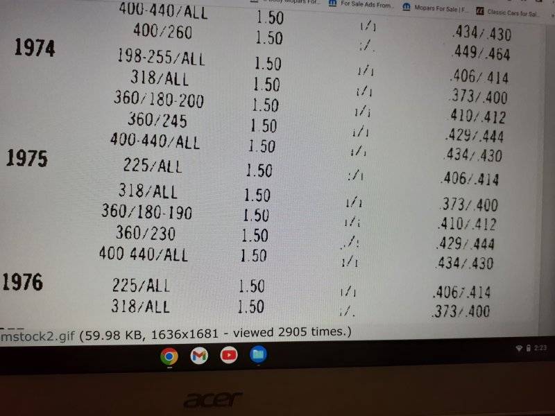

Just a quick question...
Does anyone know the specs for the stock cam in a '77 model 400 ?
I have dug quite a bit and have not come up with this answer.

stock cam for fact has 113 LSA according to the chart in the book. guessing 206-209 duration @ .50 with 425-431 lift

I am a little surprised the factory cam lifts are that much. I was expecting something under .400

The 400 cam looks like the pre-magnum 383 four barrel cam. The old 383 (and 361) two barrel cam was only .390 lift.
you could be right. the .390 was used in 1966. digging deeper, then in 1967 the 383 non performance went to .425-.437 not .425-.431 like i posted before . my book only goes to 1972 and it said 400 in the chrysler was .434-.434

not sure it matters but melling replacement cam has 208-210 duration @.050 and .431-.429 lift
