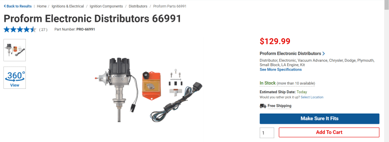

We know where this is going, I used to do these way back when. But... please provide a little more details.

Well, I started when there were only points ignition. Anyway, without any background detail here, I just jumped to one possible solution which we did many times back then. But, without any other details, it's like me saying " my backyard lamp is out, what's wrong ? "Then... " it doesn't go on".
A-men to that brother! Hard to believe that spark control has not been changed out.
