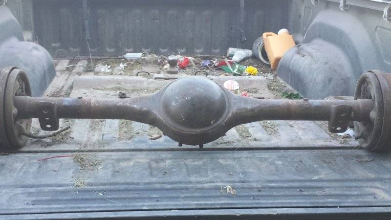

Looking for an A body housing 52 5/8 flange to flange. With Axels lug pattern 5x4.5. Anyone?

Thanks for that info. I may go ahead and shorten my existing housing and buy aftermarket axels. Do you have a good source to purchase aftermarket axels?

I appreciate all of the input guys. I think I'm going to shorten my housing and buy new axels from Dr. Diff. $300 for a set of new axels is the best deal I think. I have 2 housings that measure 56 1/2 flange to flange so I need to take out about 2" on each side. I already purchased a SureGrip unit from Dr. Diff a while back.
Unless anyone else has a better suggestion I think this is my best route.
