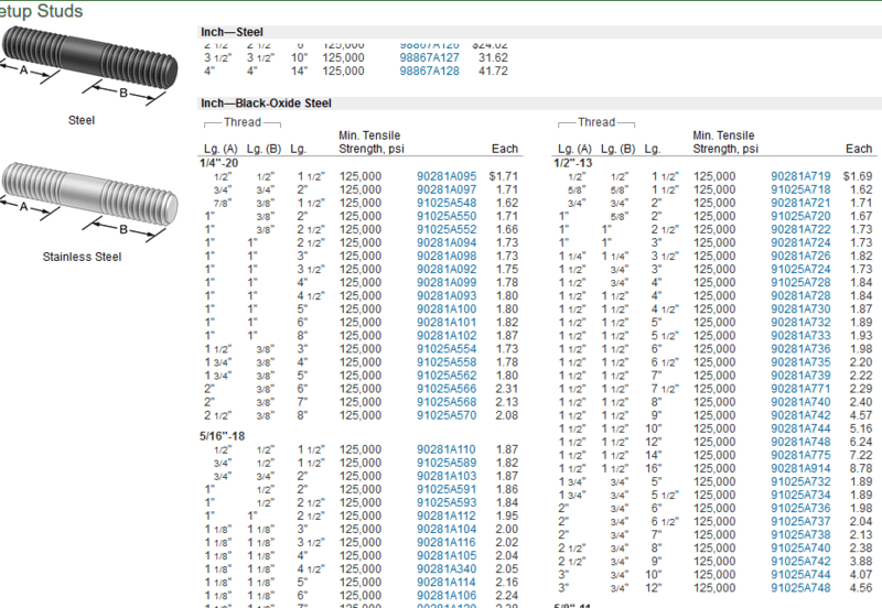

Grade 8 1/2’ bolts are what is used, but I forget the length. Studs would be perfect, maybe the 9’ uses the same?, if so, I’m sure they are easy to find.
McMaster has studs too.
https://www.mcmaster.com/setup-studs
