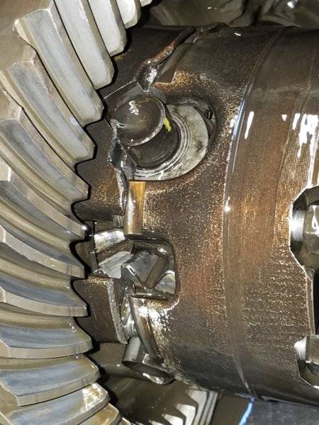

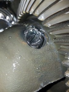

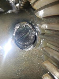

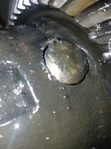

Took the rear apart the other night, looks like the shaft that held the spider gears shifted and got taken out by the pinion gear. Going to put a used stocker in there for the time being so the car can move around for the winter. Is there anything special about replacing the bearings on the axles or is it just press off and press back on?

YellowDodge67. I have seen that kind of damage before. Usually on a open differential and usually caused by somebody doing a single wheel John Force burnout for a 1/4 mile. LOL. Ask me how I know? The spider gears spin so fast they gaul the cross shaft. The shaft moves out of place and hits the pinion. Major carnage. This could have happened on any open rear axle, Dana or otherwise.

I did that (only not so bad) to a 9 1/4 by doing the one wheel peel too much with my SWB pickup that had a mildly healthy 360 in it. I tried preloading the chassis to get it where it would plant the right rear better in an effort to make both wheels track but I think pickups have too much flex for it to work well. Anyways, I stuck in an 8 3/4 with a SG and never looked back.
Pretty much exactly how it went down lol
