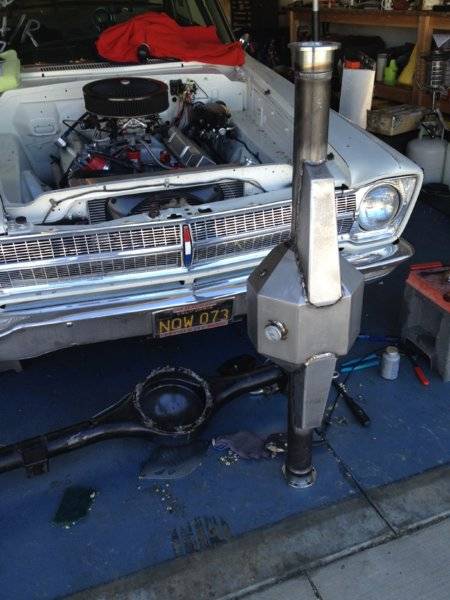

replacing my 8 3/4 Housing with this Fab 8.75 Housing & Running my 489 Center section
