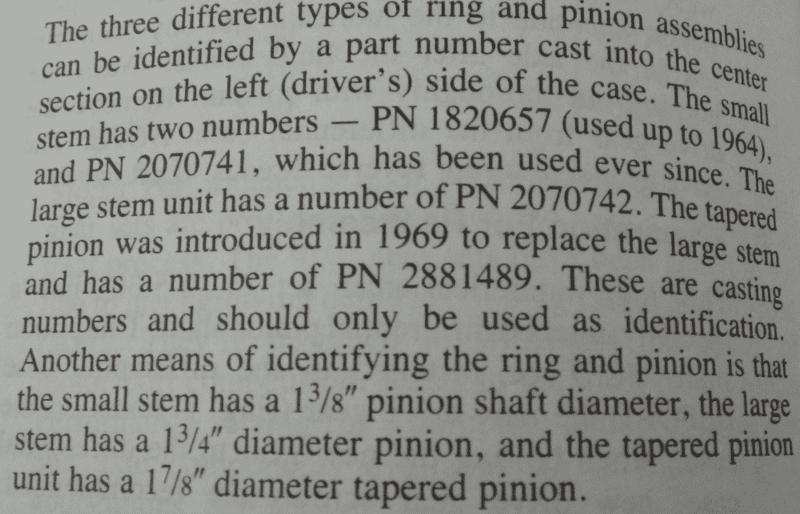

This pinion ran in a 489 case that I disassembled. Notice, that is a crush sleeve/washer/spacer on the pinion spline. It ran against the shoulder to the right. So it's seems possible to use a "large" stem in the 489 case. I doubt a "tapered" pinion fitting in a 742 case....……..
The 489 is the large stem. And I’m not seeing any crush washer.
Huge difference there between the 2. And that pinion with all the other parts is a 742.
That pinion doesn’t look to have a taper.
Somebody frankensteined that 489 case with a 742 pinion in it.
For the OP, yes the suregrips can go into any case. Take the SG case, bearings and races from one case to the other.
Ring gears are all the same across all cases as well. But don't mix and match them after they've been run with a pinion. Wear pattern difference will create a bunch of noise/whine in almost every situation.
Hey fellas. Very interesting! Keep talking about the differences. But I did just go out to the shop to take a peek at the pinion that I took out of a 67 Charger. It had a 742 case with a clutch style sure grip. Which I plan to put in my 489 case in my 70 Charger. The pinion was a large one like in the picture up above. But I took the pinion out of the 742 case. The pinion in my 70 Charger is a tapered one in a 489 case. Not like the one up above.
So there must be a way with bearings and the races that the large stem pinion will work in a 489.
Anybody confirm that??
Knock out the races and compare the numbers, something is really odd here!
