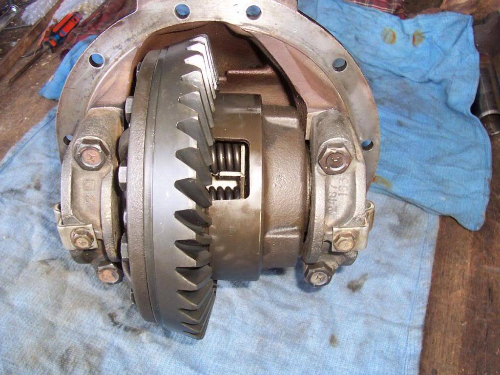

I hope this can help. I just had my 489 rebuilt and had Posi Added. 489POSI.jpg
You will have to pull the 3rd member to see. The casting numbers do not separate SG from open; they are just casting numbers for the case. Like Cranky said, there will be a clear 3.23 or 3.55 number stamped on the edge of the crown wheel.
The pic in post #3 shows a factory clutch plate style Sure Grip (Power Lock) and this one is a cone clutch type, a Borg Warner unit.

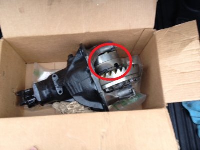

8.75 Open
If it looks like this it's open. Or, if it's still mounted in a housing turn the yoke. If the axles turn in opposite directions it's open.
