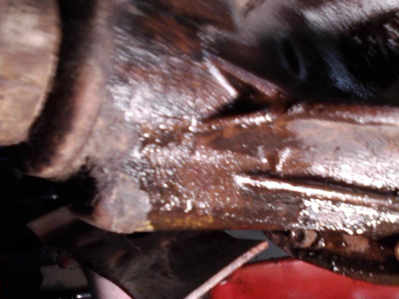

Ski, thanks for the post, again some great information. I have another question, the location of the casting numbers? Got a 8 3/4 from the boneyard Friday, still cleaning it up, but not seeing any numbers on the lower right side? Rear end came out of a Fury. Any help would be appreciated.

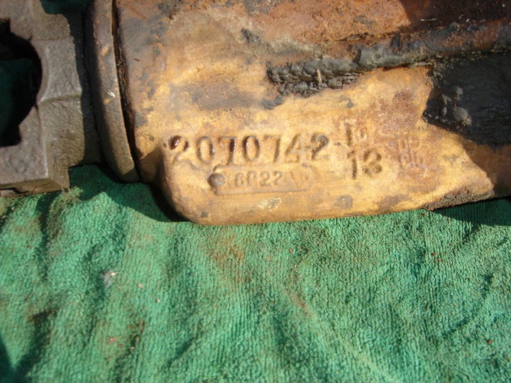

742 1.jpgDrivers side.

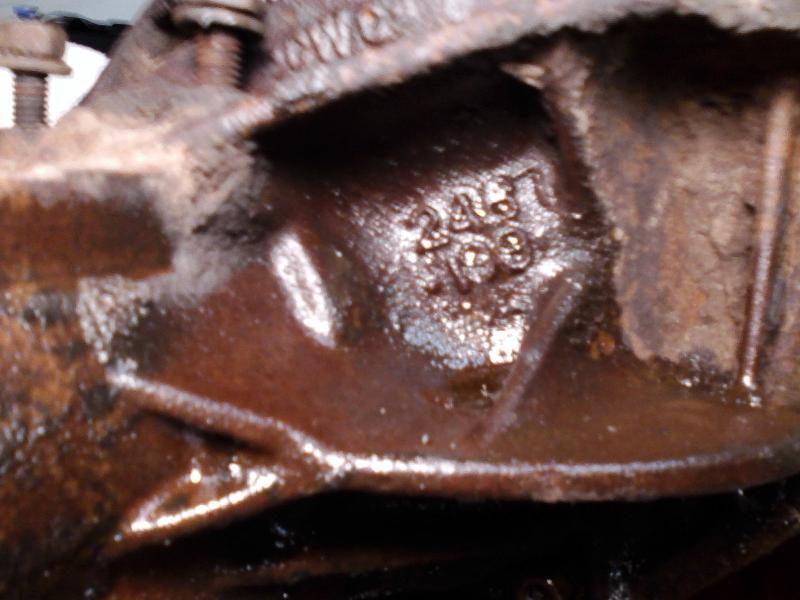

68GTX4Speed Thanks for the post. Finished trying to degrease / dirt the rearend today. Did not see any casting numbers on the lower right side. Their were some numbers on the upper part of the Center section, see pictures below. Anybody have any ideascharger 011.jpgcharger 010.jpg
