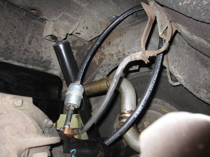

Well, I ran a loop of hose to the top of the axle hump and it still leaked. Now I have installed a good used fuel filter in the vent hose to act as a accumulator. I think it will work on shorter trips. Next step is a vent bellows-sealed system at that point. I checked the lube spec too-I'm using 80-90.

Predicted in Post #20

Thanks for the ideas fellas! I think I'll try a hose extension with a loop. I did change the lube but, it appeared that the problem has been around for a while before I bought the car. PO "babied" the car for 30 years before me and I just got back from a 250 mile trip-at least 30 miles of which were at 80 mph.

had same problem on heavy equipment took the vent out ran a 6 inch tube and vent on top. problems all gone clean tube on service and its all good.
