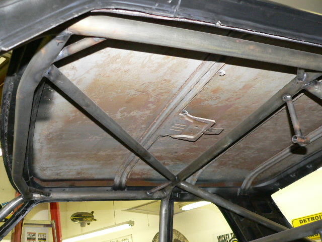

Gussets are legal in instances where you cant weld the full tube. I do not use them for that purpose. I add them for addition strength. see them in the corners?
Doug

As Doug stated, the gussets are legal and are used when the windshield tube and halo tube cant be completely welded at the top. Im in the process of putting a cage in my Colt...it will have the gussets for the windshield bar and the halo.
