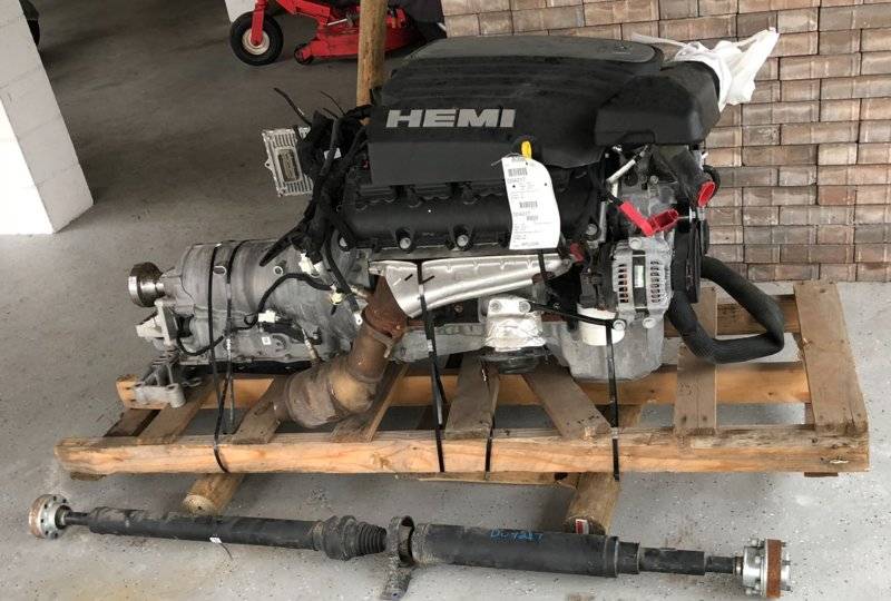

HELP! I have this great 5.7 HEMI and it’s matching 8 speed transmission that came from a wrecked 2016 challenger RT and I want to put it on my Superbird Tribute...
has ANYONE ever put an 8 speed in a b body? If so, I’d like to find out how you did it please..

Without the original computer, the transmission will be useless. It absolutely will not work. EVERYTHING in that transmission is computer controlled and nobody offers a stand-alone computer for the A8 automatic transmission.
When the "RoadKill" guys put the Hellcat engine and A8 trans in the 68 Charger, they used a factory computer that actually required them to rig up the original taillights from the Hellcat. You see, the transmission requires various electronic inputs from several points in the car.

So here’s additional info. I have the following from the wrecked Challenger RT:
5.7 Engine
8 speed automatic transmission with rear transmission mount (which will need modifications)
Original Computer
Original Harness
Original shifter
Original Anti-lock brack module
What I’ve purchased from Dodge using the wrecked vin number:
the body control module
star connectors
new key fob
wireless ignition node (the start button)
ref hub
and a passive entry antenna.
I also purchased a set of motor mounts from Mancini Racing, I’ll probably need to fabricate a rear trans mount, unless someone knows where I can get one...
Please offer guidance, this is a major undertaking for a backyard mechanic..

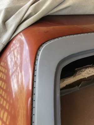

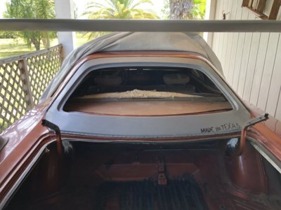

I just glued in the back window plug,,lotsa work...

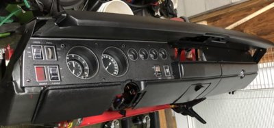

Thank you, I just finished restoring the dash, I just need to put it in the car, delaying until I add a vintage AC kit, and I’m still deciding how to get everything to connect up....right now, it just looks like a rallye dash... the car is in LaBelle, Florida at my farm..it’s a small but well appointed private shop for a backyard mechanic... let me know if you’re ever in South Florida...you’re welcome to drop by..
DCDB033B-44CB-434B-917D-407FFB1C1401.jpeg 6988BD3F-898D-4380-8FEB-80E821AC8E34.jpeg
PS, I know the emergency light switch is for a 69, but I wanted that switch to use as an accessory switch..
